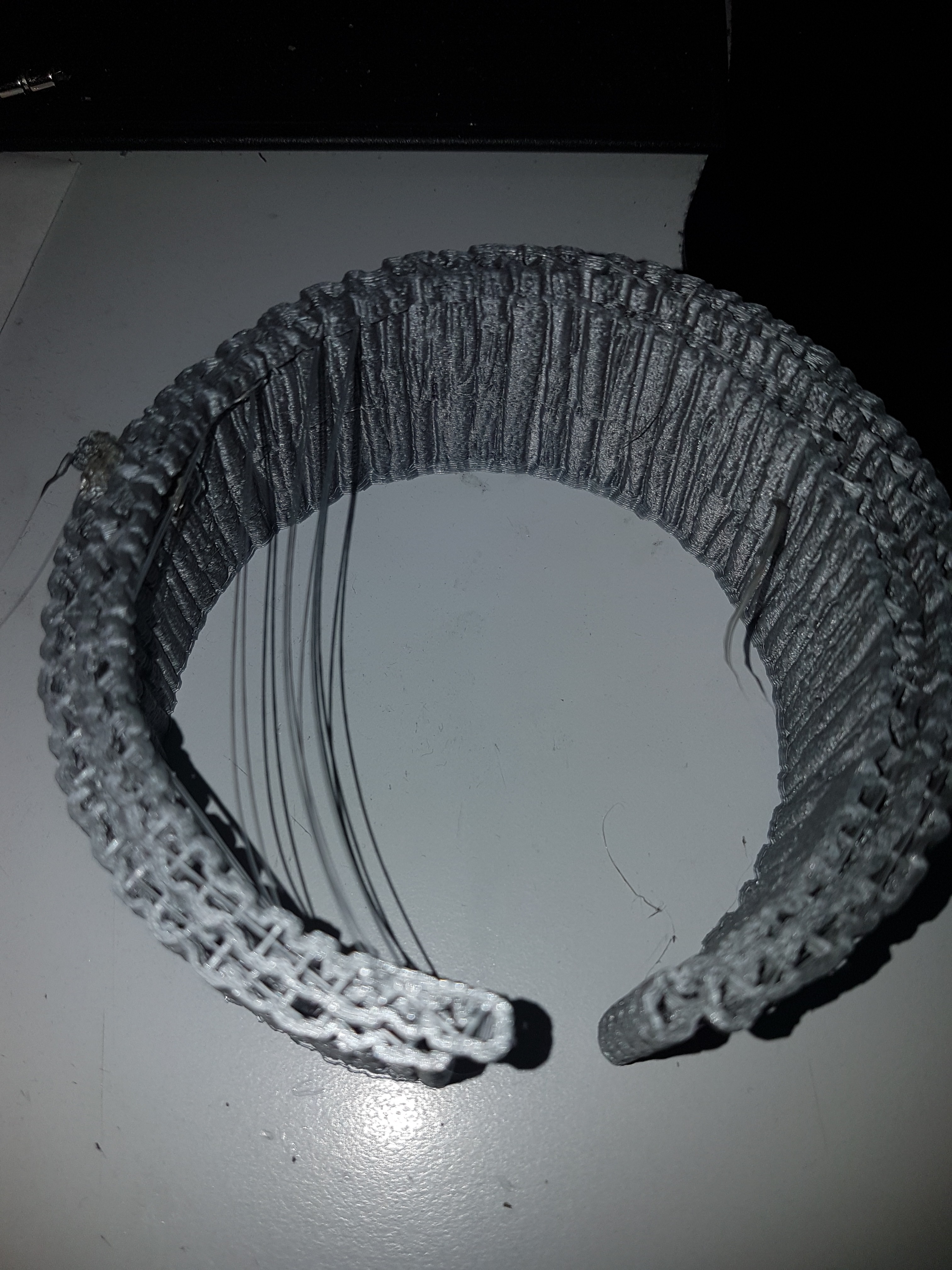

i'm getting strange blobs on some of my bigger prints (see pictures attached).
i’m getting strange blobs on some of my bigger prints (see pictures attached). the massive layer shift in the print is caused by the blob blocking the nozzle i think, so please ignore it by now.
Any idea what may cause these blobs?

Could be a lot of things. Over-extrusion, not enough retraction, temperature too high.
Also, I wouldnt expect a blob to cause a layer shift, that sounds more like your motors current is set to low or your belts are slipping.
Test your extrusion rate. Make sure that if you tell it to extrude 100mm it is extruding 100mm. Then printing some calibration cubes and other test prints. Measure the dimensions to ensure that you are able to print accurately and that you are handling bridging and travel correctly.
The problem with trying to diagnose issues with a large irregular shaped print is that it is hard to tell what is intentional and what is due to printing problems. For example, I’m not sure what you are trying to print and how much of the irregularity in your groves is intentional.
Update your firmware
Run PID
You also look to be running your printer too hot

@Christian_Schulz I didn’t think the blob was intentional. If ever I encountered a large blob in my printing, usually the object to being printed would get dislodged because the force of the motors would overcome the adhesion of the object to the bed. If your print head is bouncing off a blob then either your belts are to loose or the motors are not getting enough current.
Personally, I don’t think you have a pid tuning issue but if you don’t know how to tune your printer, I would check out this website page
https://reprap.org/wiki/PID_Tuning
Zooming in on the images you posted, I would definitely say you are over extruding.
The blobbing and stringing are most likely due to printing at too high of a temperature.
