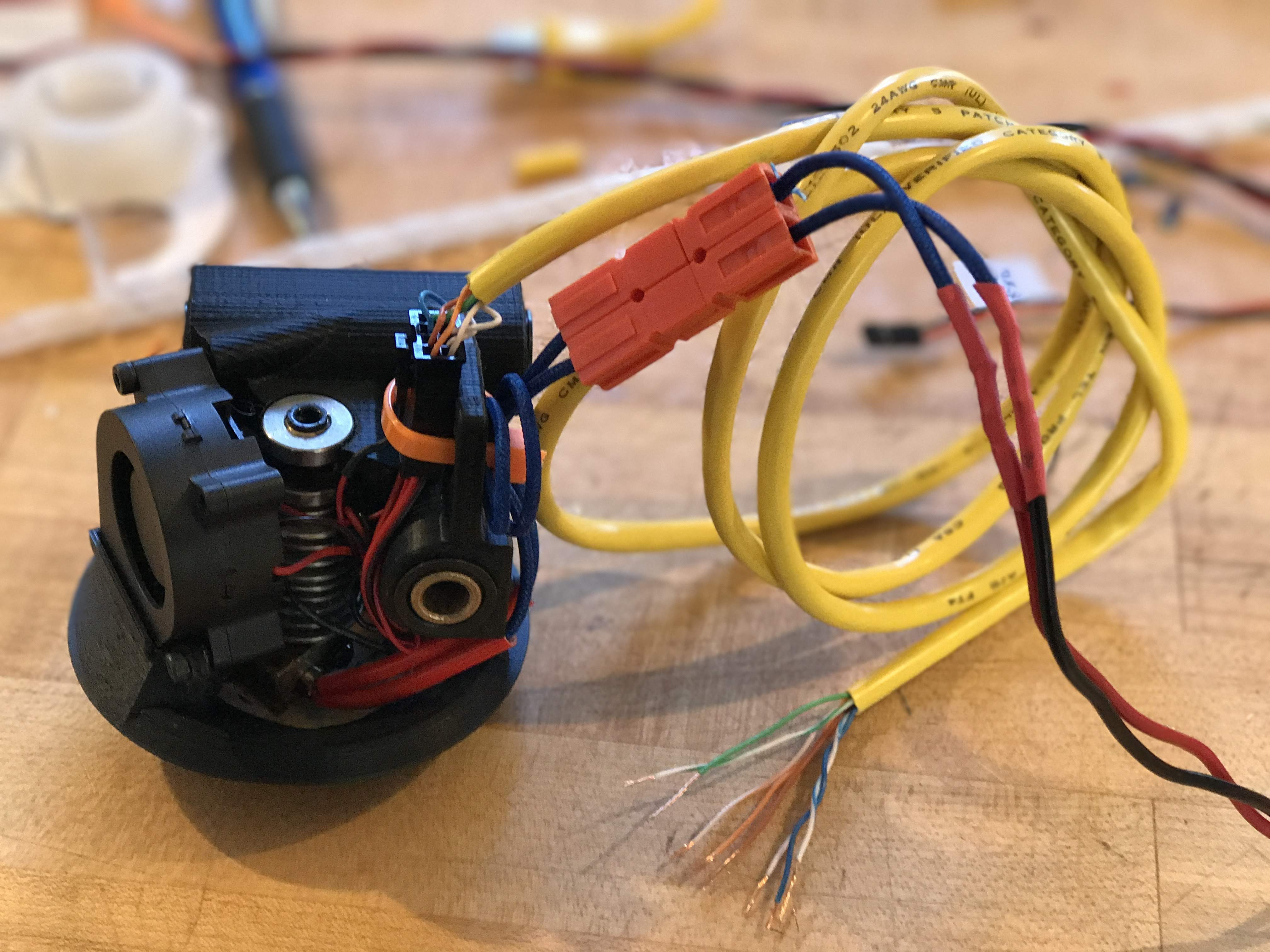

Can you provide detail on which Molex connector you are using?
That’s a powerpole connector
I see that now. I think I’ll be getting some.
Sorry, I’m away from the computer that has my notes, I’ll get you a parts list in a bit…mostly because I had to order twice to get everything I needed.
Also, I’m not happy with a strain relief yet.
i’ve seen others and started useing XT connectors, either XT-60, XT-30, XT-10’s (the 10’s are smaller than the 60’s) which are used in the RC world. Seem to work pretty well.
Parts used for wiring:
Cat-6 ethernet (thanks @Thomas_Sanladerer )
PowerPole ACP-15
http://powerwerx.com
Molex:
(Male Plug) 43025-0800
(Female Plug) 43020-0801
(female inserts x8) 43031-007
(male inserts x8) 43030-007
(I added more plugs and inserts because I have multiple printers, and I expect to screw up a few of the inserts)
I used your list to purchase two position versions of those Molex connectors.
