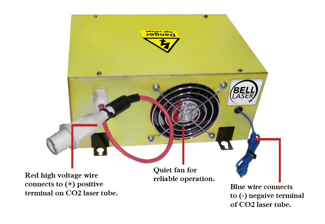

The Anode is positive, the thick high-voltage wire. Red on most set-ups. it’s the one that comes out of the back of the power supply. It will go directly from the highvolt out on the power supply to the tube, and is the one you want to silicone. It’s @ 15kv over the rest of the machine.
The Cathode (Ground or negative) is just a regular machine tool wire (since it’s tied to ground thru the Ma meter, it’s only a few volts above ground), and goes back to ground thru the Ma meter. It connects to the positive side (because it’s MORE positive than chassis (actual) ground. Then the Ma meter goes directly to the ground connection at the power supply.
Sorry if it’s a confusing description, the simple answer is the big red wire is the high voltage one. (edit - Positive (anode) is the beam end)

Anode = Positive = Emitting end = Red wire (usually) Insulated with boot and silicone seal. There should be NO other connection here - straight from PS to tube.
Cathode = Negative = Ground end (non-emitting) = White or Black wire (usually) = Ma meter “+” terminal

Found a good drawing online, link:
