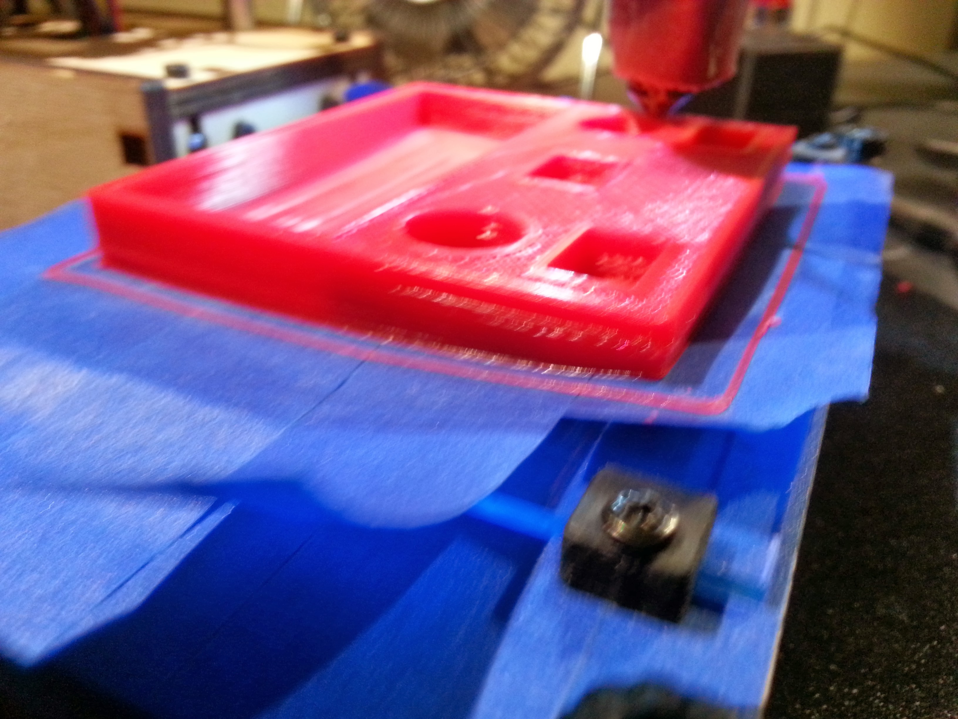

I'm having a new problem on my PrintrBot Simple:
I’m having a new problem on my PrintrBot Simple: Curling. This is the largest print I’ve attempted, taking up most of the build area. It seemed I had to go a bit hotter to get both filaments to extrude reliably.
I tried printing in Coex red PLA, 210C, 0.3mm layers, 50% infill, fan on, and got terrible curling at the corners, pulling up the blue tape.
I tried again with PrintrBot natural PLA, 200C, 0.3mm layers, 10% infill, with an additional desk fan blowing on the part, and still got curling at the corners.
What am I doing wrong here, folks? Maybe because it’s about 10F cooler in here than it was when I printed my last large item (about 75% size of this one)?

Try setting a brim in your slicer. It increases the surface area when printing with the hopes that that will lift a little as opposed to your part. Also, is your tape fully stuck down on the bed there? It looks to have lifted a little in the middle.

Thanks for all the suggestions!
I’ll try the brim, though I don’t have much room for one on this print.
I’ll also clean the glass I have on the print bed, then tape, then alcohol to try and get real good adhesion of print and tape.
I’ll keep the fan off, and heat up the first couple of layers. I may even try heating up the bed with a heat gun (no hair dryer; no hair).
I’ll let you know how it goes.
