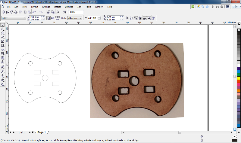

I’m having a problem with my k40, it runs and cuts great, no errors or weird sounds. But the cuts don’t match my design. I made the dxf in draftsight, then import and cut with corellaser. Anyone have any idea whats happening here?
All my settings are default in corellaser. It’s weird because the four corner circle cuts are correct relative to each other, same with the four rectangles, but the position of the circles relative to the rectangles and to the outer edge is off. I tried messing with some settings in corellaser, but it just made the problem much worse, so I went back to default.
That’s interesting, because as you say, everything is in correct x-position, and y-positions are correct on certain elements, however just the entire circles section is offset somewhat on the y-axis. I am curious as to whether the entire process was cut at the same time? I also wonder if there is something wrong with the import process from your dxf/draftsight file (never used it before). Maybe CorelLaser stuffs it up somehow.
Yes, it was all cut at the same time.
I’m also suspecting something with the dxf file. Draftsight has 16 different versions of dxf to choose from when saving, I’ve only tried two, with the same results.

Make sure you have the correct machine selected or you’ll get strange results. If that’s not the issue, and it’s not another software setting being off and the issue repeats exactly the same, then it’s likely a import/export file problem

In that case (cutting directly from Corel and/or LaserDrw is off) it’s likely your machine or settings in the software. You don’t say what model machine you have but double (triple) check your machine model selection. If you are absolutely positive it’s correct, draw some simple squares/shapes and test mark on paper and see if you are loosing steps on an axis.
If so, slow it down like Brooke suggested. If you are already at a reasonable speed, try to locate the cause (loose belt, pulley allen screw etc , or possibly even a bad wiring connection). These have little quality control when built and travel a long way so are notorious for loose parts and connections. Also, if the machine is powered off, the x/y should move freely and not bind or catch anywhere. A bad stepper or electronics is a possibility, but first eliminate mechanical possibilities.
I had the wrong machine selected, haha. I don’t have time today to see if it works right, probably will tomorrow.
Now that I have the right main board selected, my laser cutter works great, dxf’s are no problem, and it’s very accurate.
What had confused me was that on the cutting screen in corellaser you select your tool, but there is only one option, the 320 laser machine, so I thought I had the right one selected. But thenI went to properties, and realized there were 7 different mainboards to choose from, and the default was the wrong one.
I’m very happy with it now. Thanks for the help everyone.
