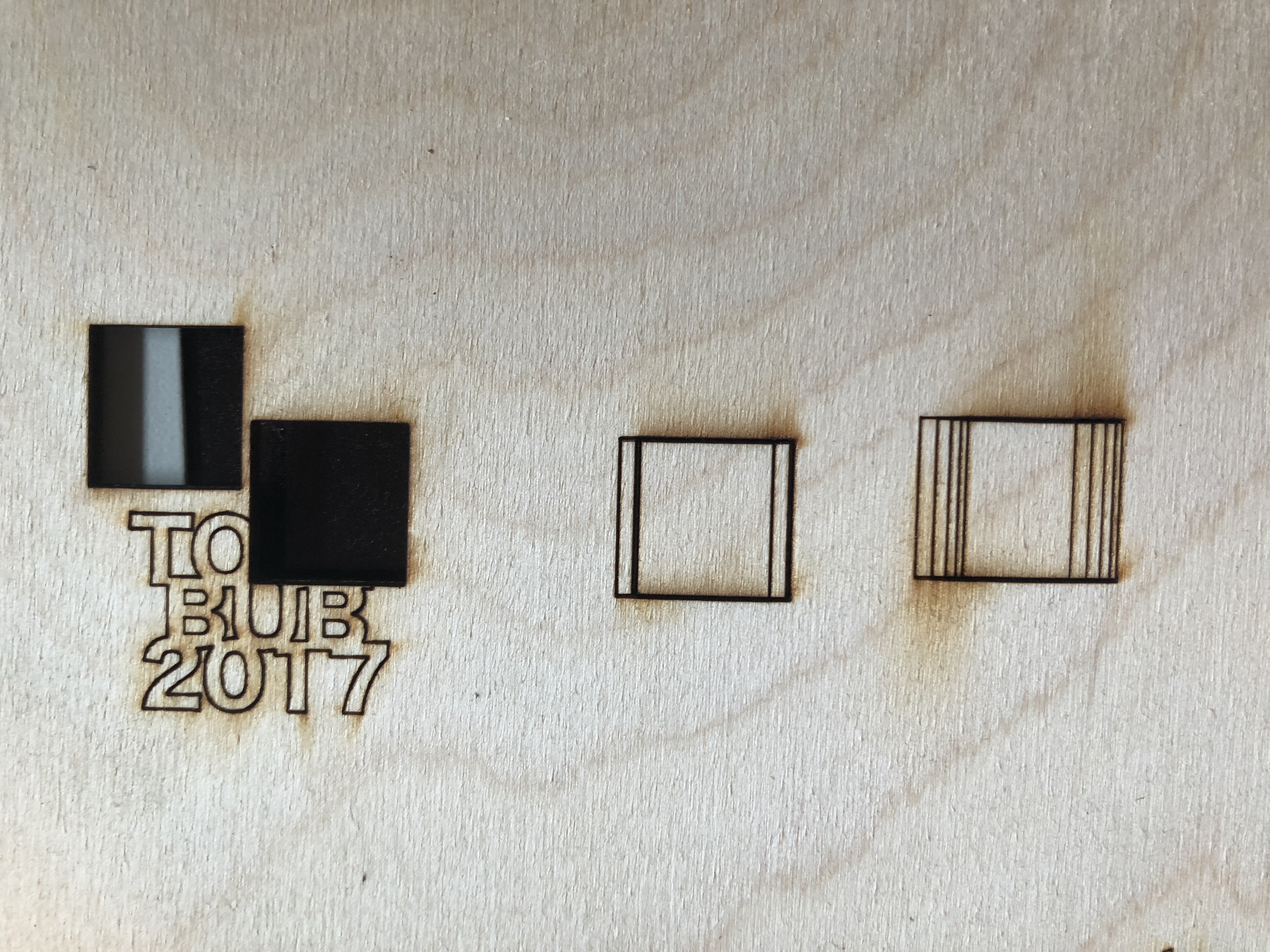

From what I can tell, I’m losing X-axis steps, but in an inconsistent manner. Here are two photos that I think help. The first photo shows some successes to the left. The complicated text seems to cut out fine, wherever that file is in the laser bed. The squares were simply cutting the same file twice to be able to get through this plywood. To the right, you can see me cutting the same square a few times (ie, a new job from Visicut each time) and it is losing x-axis position. Trying to run a more complicated file (right photo) shows that it loses x-axis position even within the same file.

possible mechanic issue on 1 axe only,
check if the screw holding the poulie doesn’t come loose. at the the same time look the belts tension.
Thanks Stephane. I put a mark across the shaft and pulley, it doesn’t move so that is not slipping. The belt tension seems okay to me. If I slow things way down, I don’t lose steps, so your intuition might be correct. I’ll keep poking at it.
