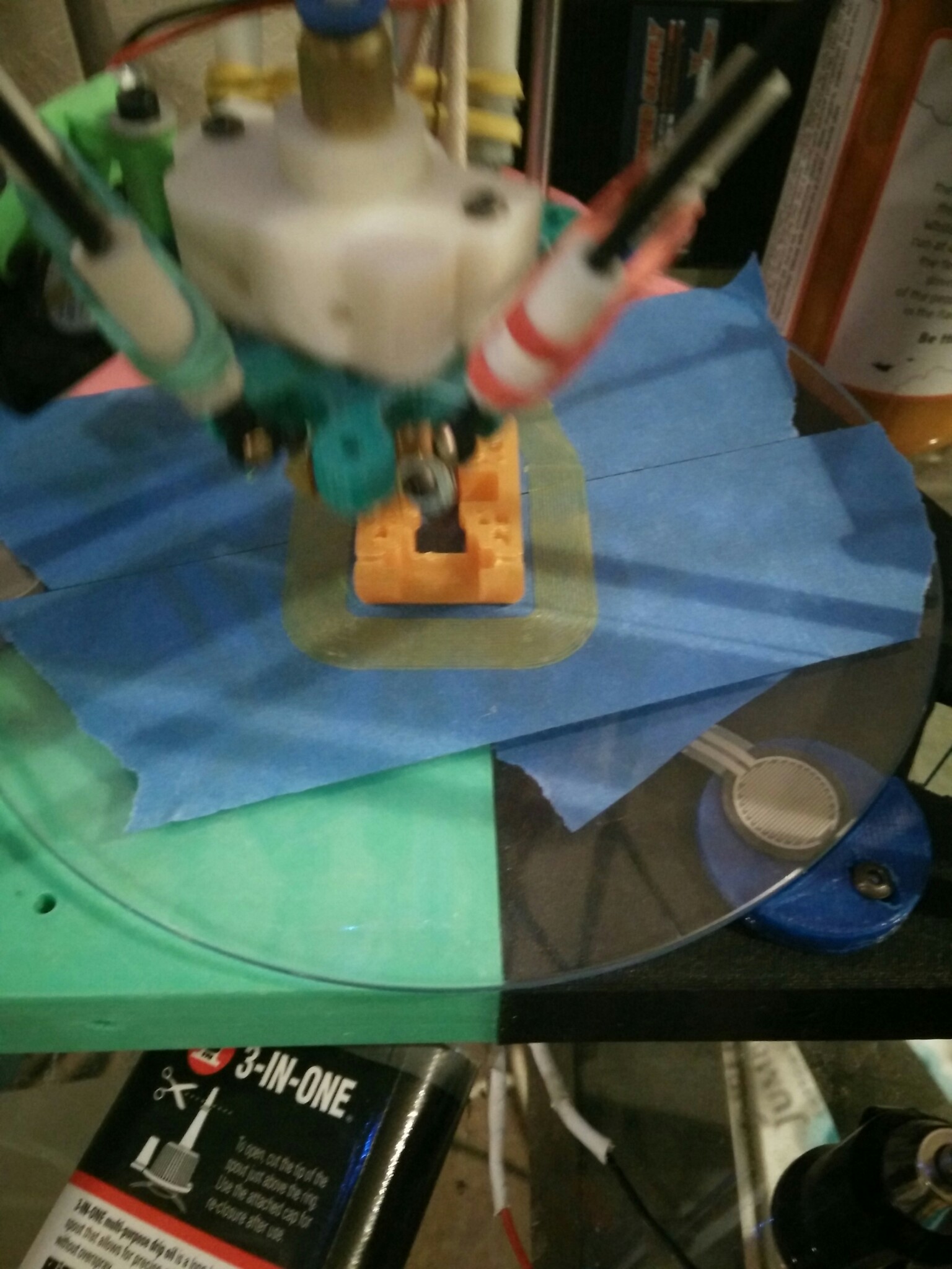

I'm having an issue with slic3r 0.9.9 on my PC.
I’m having an issue with slic3r 0.9.9 on my PC. I’m telling it only to do 2 loops but it’s wanting to do about 10x that. Anyone seen this before?
Did you accidentally mousewheel down to concentric infill?
Looks like in still on honeycomb
Under the glas right side is it a sensor?

So I deleted the config file and recreated it and it seems be gone now. Also I haven’t dialed my stuff in well enough for Cura though I’ve heard good things.
@Sebastian_Schmidt
Yeah I was going to try out the FSR sensors but I broke one in the process so I’m waiting on a replacement. I’ll let you know how it goes.
@Wes_Brown for what is it useful?
I dont hear it before :frowning:
It should allow me to tap level my bed. See this: https://www.youtube.com/watch?v=HcnhCNh2Ln4
So far I’ve not had any luck as I have sooo much play in my effector due to crappy bearings an general meh. Hopefully I can solve this with v-slot.
