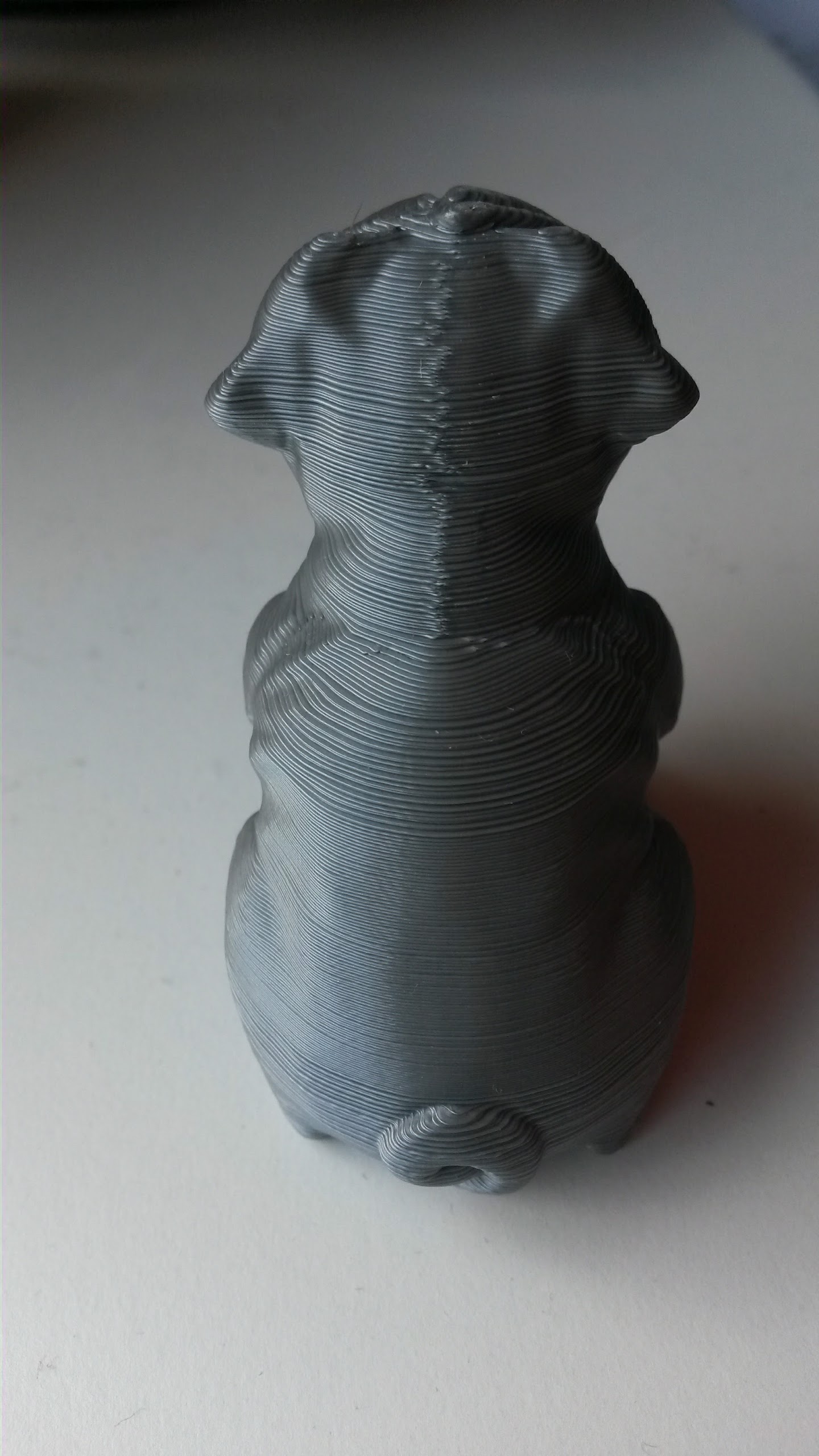

But I still don’t get the quality out of it as I expected. The pug is printed from the accompanied SD card to rule out slicing setup errors. The part right above the tail up to the chin is perfect for some odd reason, but the rest of the print have banding problems.
The white Aria is printed with faberdashery white PLA (which I found afterwards is underextruding about 6%). The gray Aria is with the Prusa PLA that came with the printer. Both printed with same gcode.

I just recalibrated XYZ with the new firmware, and now the pug came out with the good layers in different places. Weird. Printing another one now just to check if the problem is symmetrical. Will post pictures later.

These are printed yesterday back to back with the exact same gcode. So the mechanical error is not consistent, since the layers have problems in different places. Notice the head.
Edit: calculated my extrusion to be off, trying another one now with a multiplier of 1.06.
So, did another one with M221 S106 spliced into the gcode file. Noticed no real difference, though there were a bit more “perfect” layers.
Then I printed antoher one at 50% speed. And it came out as perfect as I’d hope the MK2 to print.
