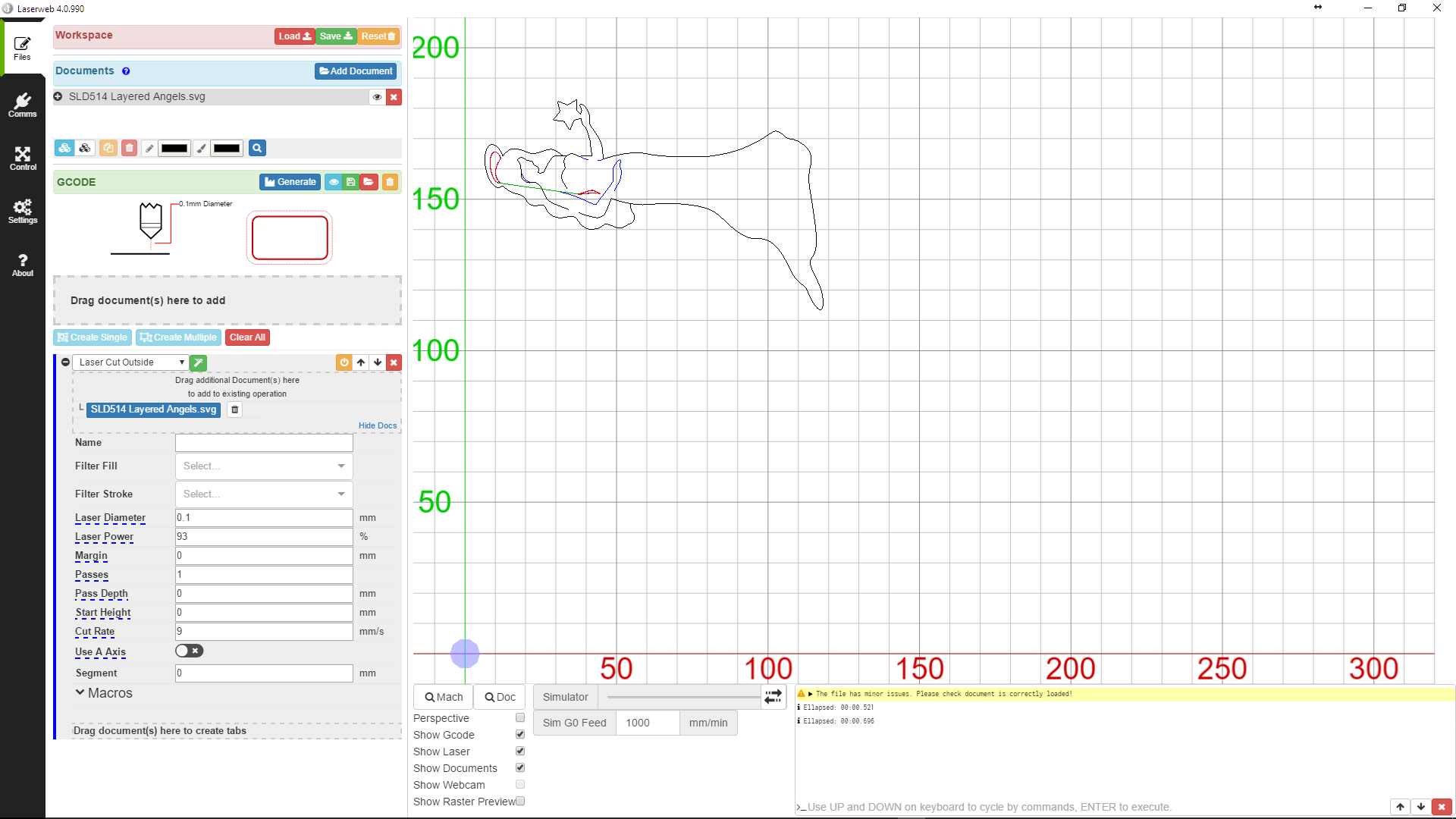

Can you please post a screenshot on how you are creating the operation and the outcome of the gcode

Yeah but I’m not asking for the gcode. I’m asking for a screenshot on how you are creating the operation
I guess I don’t understand exactly what your asking. A screen shot of laser web maybe?
Settings in LW?
He wants a screenshot of the settings for the cut-operations

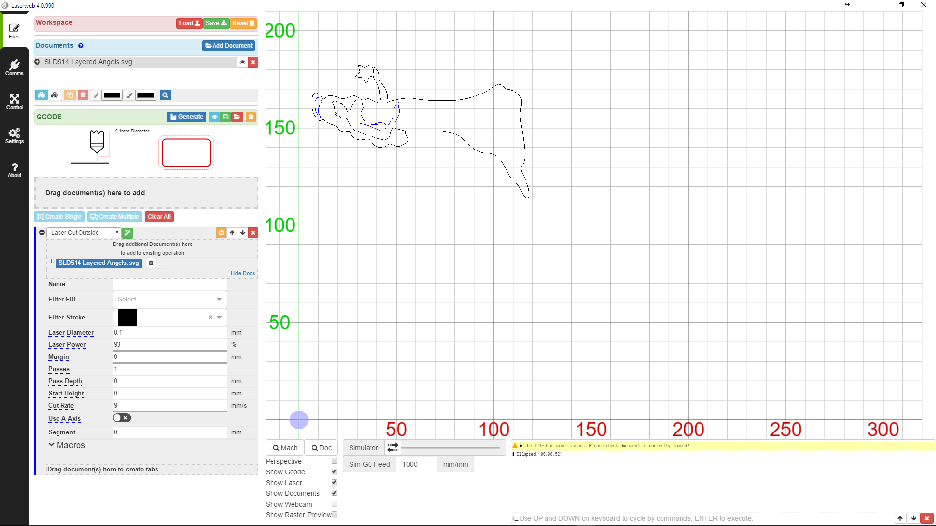

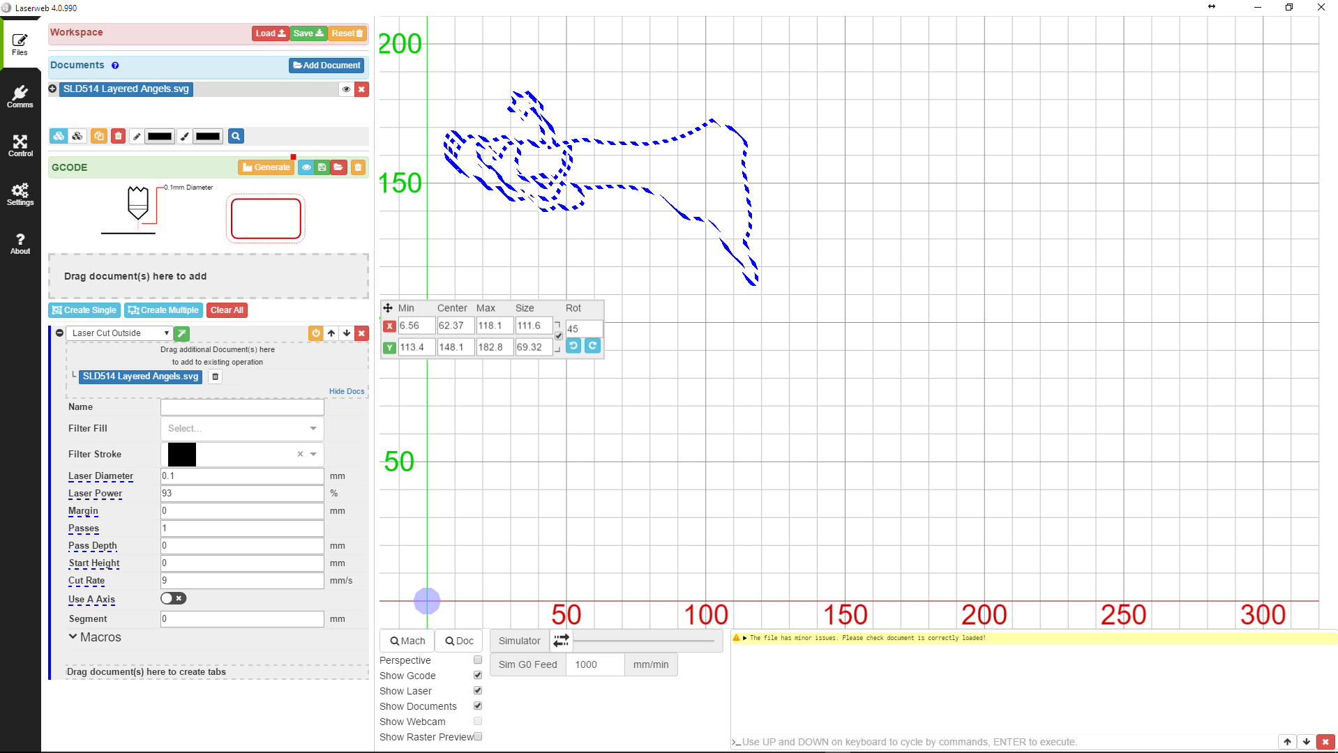

Inside and outside cut for a closed path will not generate gcode in that case. Not sure the reason as there seems to be space. Láser Cut operation does work and generated gcode for all lines. Please look at my image
Will give it a try that way.
Worked like a champ. Thanks so much!!!
