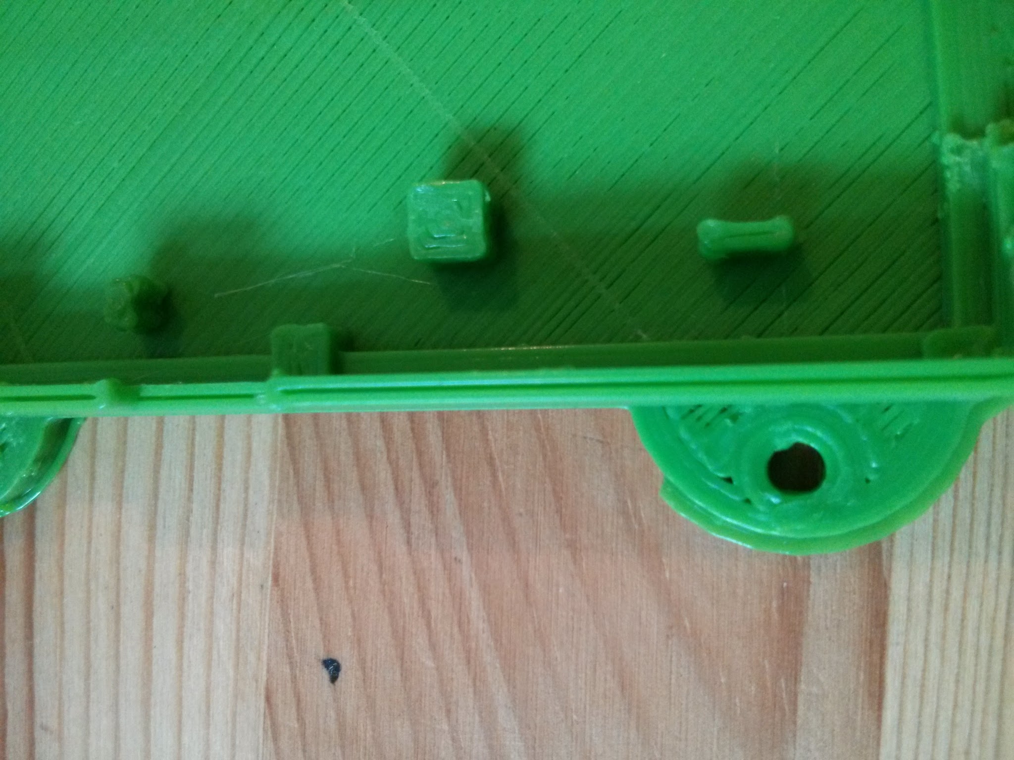

I’m having problems with thin walls where no infill is used. The layers don’t stick together creating hollow walls. Can anyone give me a tip what I need to tune? Would making the filament width smaller (eg. 1.7 instead of 1.75) in the Slic3r make a difference? what would be a good value? 1.7? 1.6?
What version of slic3r are you using? The newer versions (i think starting with 0.9.7) try to fill those gaps. Decreasing filament width would indeed increase the amount of filament extruded, but would make for a quite messy and ugly print.

I’m using 0.9.9 but I don’t see a “single wall thinckness” value in the generated gcode. Is it “perimeters extrusion width”?
You’re right, it’s “perimeters extrusion width”.
Try 0.9.8, though, it should fill those gaps.
And you might want to check your axes for backlash, that infill looks like you have some in X or Y.

measuring a single wall (using the skirt trick Thomas mentioned) I get about 0.8 to 0.9mm instead of the 0.7mm Slic3r assumes. So we’re on the right track I guess. Now the question is: should I adjust the “extrusion multiplier” as Thomas suggested or directly set the “Default extrusion width” as Anthony seems to suggest?

@Andreas_Gohr the default extrusion width will not change the amount of filament extruded - if you change the extrusion width, the actual width will proportionally get thinner as well (volumetric logic). The gap you’re seeing will become wider as well, maybe even wide enough that the old slic3r will fill it with a single extrusion.
0,8 / 0,9 for a wall that’s supposed to be 0,7mm seems a bit extreme, though, and the exact opposite of what the infill appearance suggests.
@Thomas_Sanladerer yeah, I was kind of surprised by his calculated extrusion width myself as well. The gap in the wall, as well as the infill, seems to suggest that the width would need to go down, not up. (At least how I’ve always understood it)
I tend to believe that the optimal extrusion width is pretty much a fixed value for a given nozzle / hotend. But yeah, if Andreas wanted to adjust it to fill the center gap, it would need to be decreased to at least 1/3rd of the wall thickness of the object. Newer Slic3rs will not care about extrusion width and automatically decrease it for the center channel, while the older versions simply decide that the extrusion is too wide and would overfill it - hence the gap between the wall.

I think what happens with Slic3r, is that it determines that the wall is too thin to get the nozzle into, and skips filling it in. I get this even on 0.9.9-dev from the github repo. Sometimes I fake my nozzle width down to 0.49 in order to get those areas filled.
@ThantiK that’s weird, since a couple of versions the thin wall gaps I’m seeing have drastically decreased. Maybe that’s a regression introduced after 0.9.8?

Setting the extrusion multiplier to 1.02 seems to have fixed the problem. I’ll try 1.01 on my next print. Thanks for your help guys I learned something new today (for example that my calipers suck ;-))
