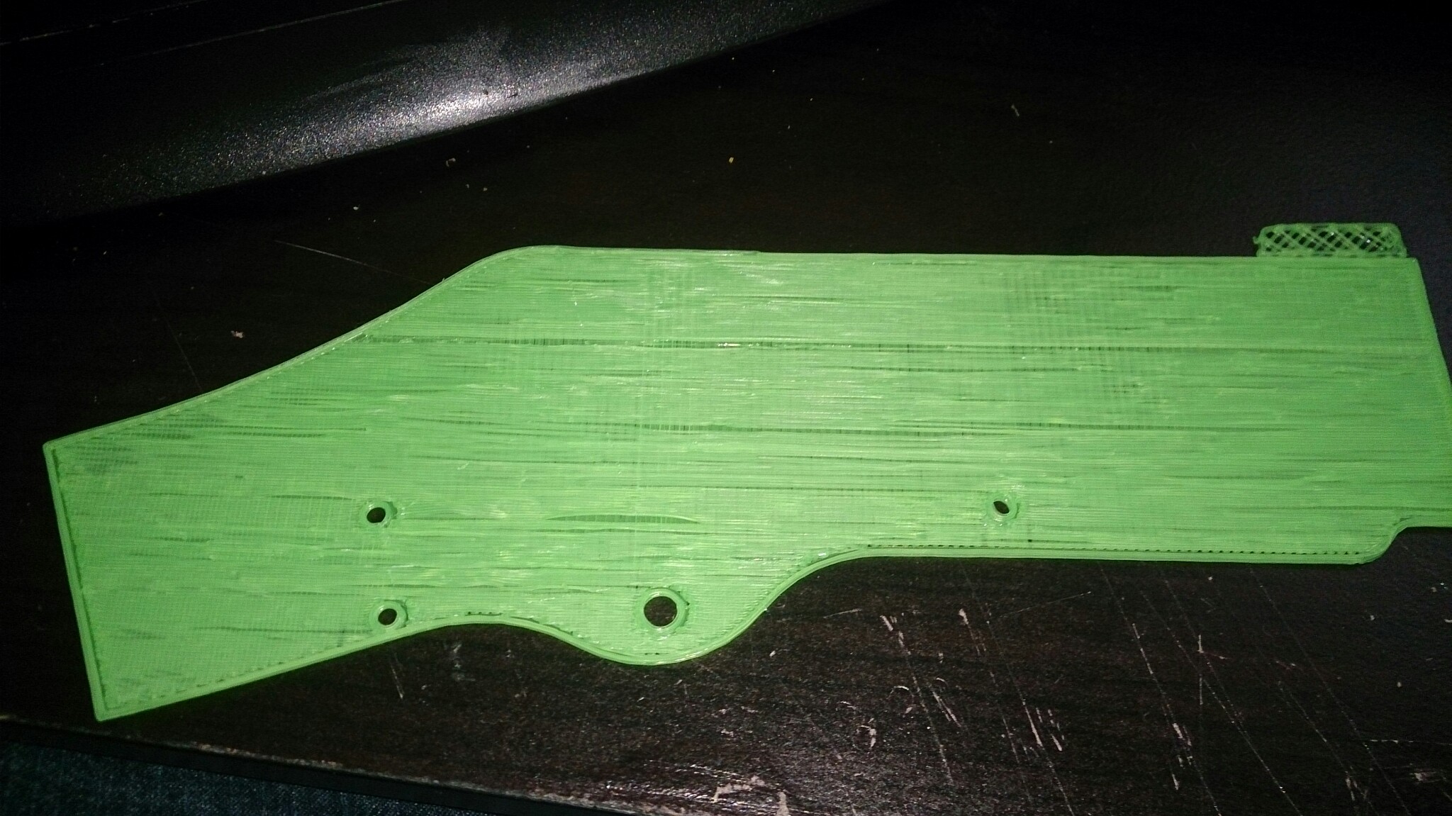

I'm having some more problems,
I’m having some more problems, the first layer of this print comes out fine but the second layer doesn’t seem to want to adhere to the first. I can’t think of what could be causing this, I’ve tried physically lowering the z axis during the print, but it only helps for a short while.

What does your first layer look like? From what I can see in the photo it does not look that great. Have you calibrated your extruder? http://reprap.org/wiki/Triffid_Hunter’s_Calibration_Guide

@Troy_Sorzano I’ll try to get a better picture, it doesn’t show well in photographs, I’ll have to fiddle with my camera settings. I’ll check out Triffid Hunter’s guide in the meantime.

@Aaron_Leclair here is the prusa calc try modifying your firmware with the numbers generated from the calculators. Leave the extruder steps alone though. But also change your x and y just in case. It truly appears to be a z problem. there is no smushing of the second layer once it raises from the first. also check if there is any mechanical slop in your z or bed leveling system. you know springs with little to no tension for the bed or loose allens on couplers for the lead screws
Careful! Don’t let the NSA or such like see that photo! It looks a little bit like an attempt to 3D print a gun.
