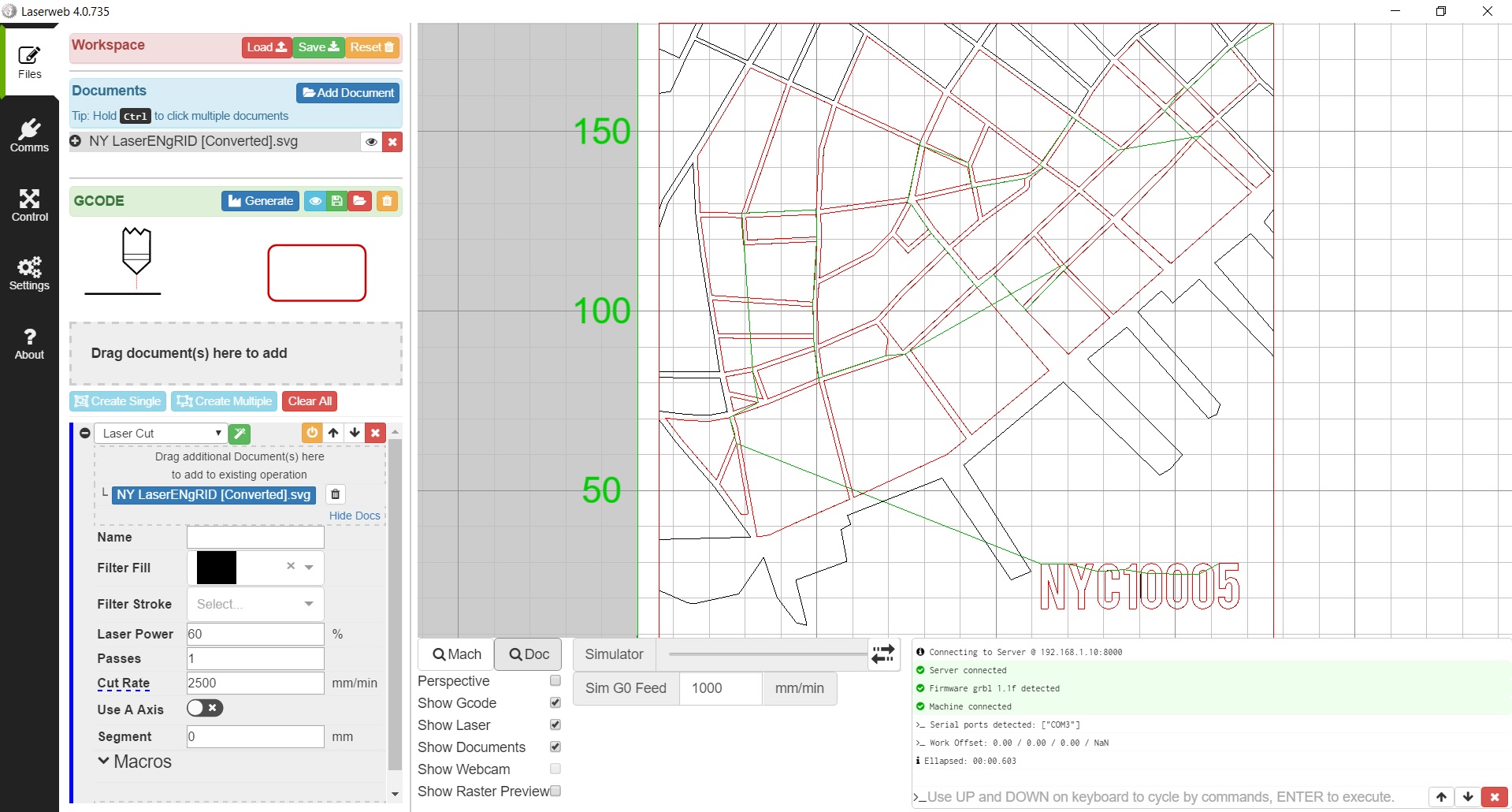

thank you, now I’m able to load the file in the grid with ALL the objects, but for some reason, it seems the GCode is created only for polygons that have closed perimeter. every object that is not closed, is ignored.
Save your workspace file and post it so I can see why that’s happening.
let me know if you can download it: https://file.io/exv1rP
Clear the Filter Fill option.
