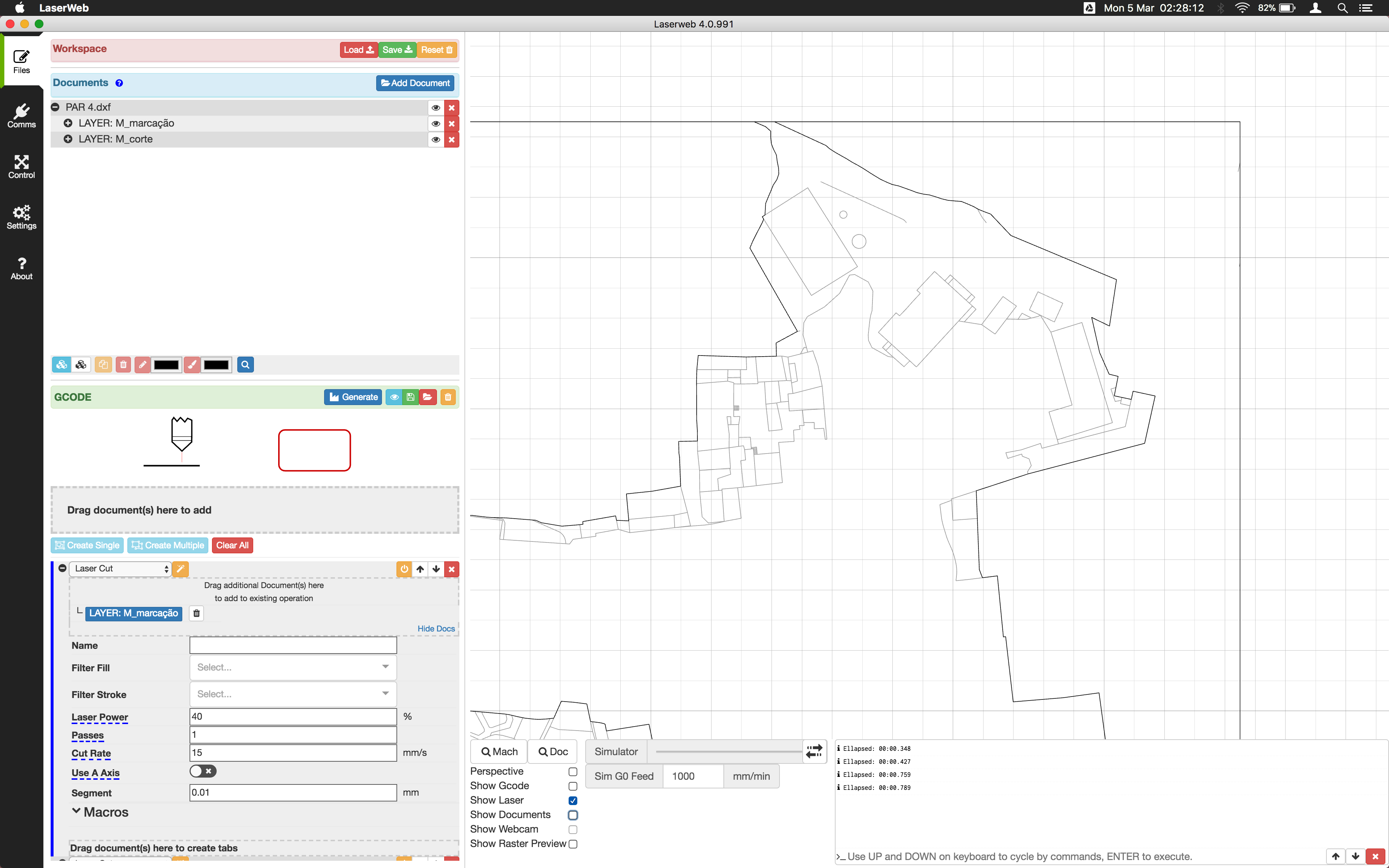

I’m having trouble cutting a dxf from autocad where a few lines get ignored for some reason. they show up in document, but not in the generated gcode. I searched and found a post by Dan Shookowsky, but it was related to svg. I had his issue before but solved it by lowering segment size to 0.01mm. yet no matter how small I set it, these lines don’t show up in the generated gcode.
I know they’re not joined, but many other lines aren’t joined either and do show up.
Any insight is greatly appreciated

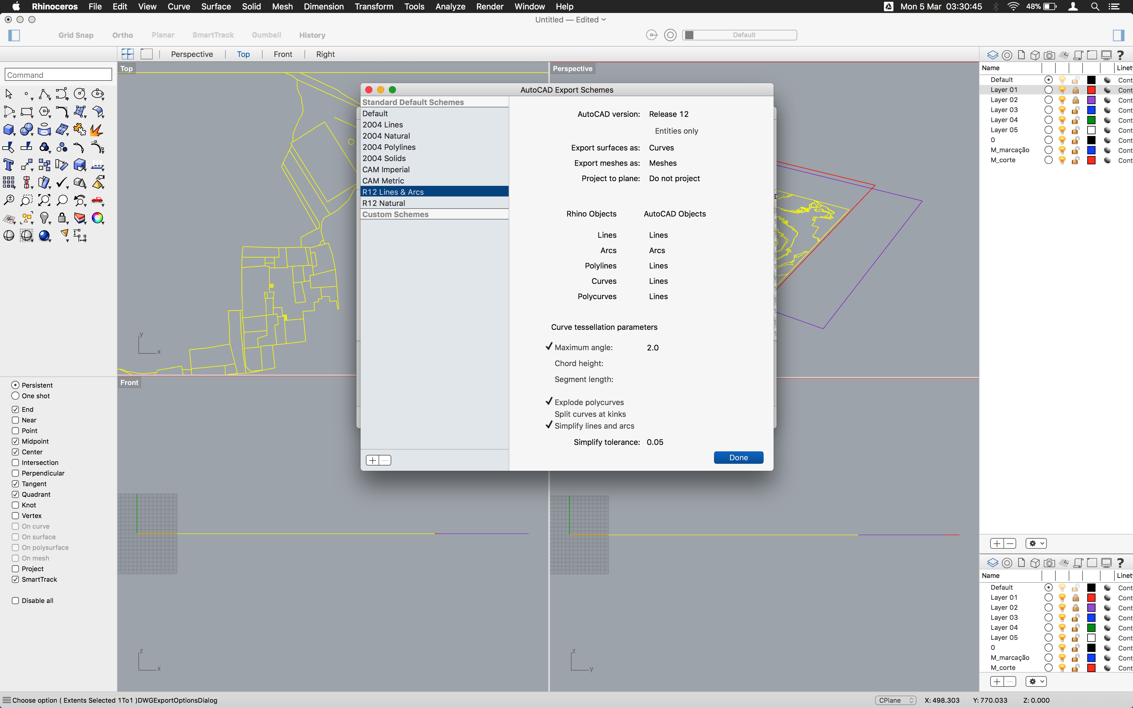

so, apparently saving as R12 with these settings (I’, using Rhino3d to read the autocad dxf and exporting it again) solves the problem, but makes laserweb grind to a halt from the moment you load the file. but it works. I’ll see if any other settings work without taxing LW as much
