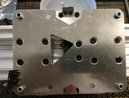

The recessed holes go facing rear, or away from the X beam.
The limit switch faces down.
You should be able to install same as the directions would normally request.
The limit switch should be on the back of the X gantry and facing down. Catches the bottom plate on the Z axis.
Is this correct? Or rotate plate 180 degrees?
Flip the back one 180 degrees for the limit switch to face down.
