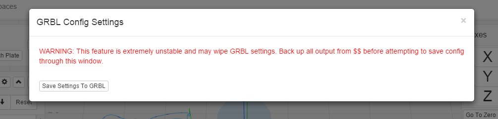

I seem to be having some issue with GRBL set up file, when I press the “Save Settings to GRBL” nothing seems to happen.

I think the settings on the arduino are saved automatically so if you type them in and typing $$ shows them, I think you are good. If you power off the arduino and power it again and it remembers the settings, that’s all you need. I’m not sure what that button does, but I don’t ever use that. Just type directly in the GCODE commands window the $ commands to change the settings.
