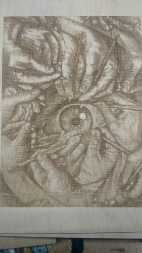

All my grayscale engraves are done at 7ma set on my potentiometer for 100% and depending on the material I will set power scale in laserweb to 60-100% for most objects… I would suggest you get a 0-100% black calibration image and test different speeds and top power settings… also note post processing can reveal what you thought was a failed engrave… I use 400 grit sand paper and do a light sanding before and after I engrave an image
Before post process…
After post process
