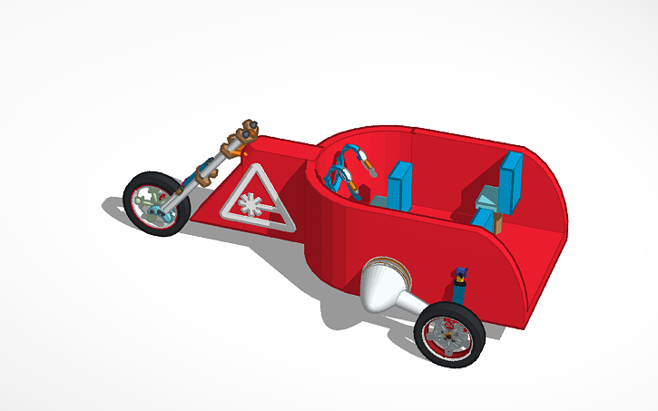

Yes - it is limited, however, it does most of the stuff I need to do for now. One can learn to overcome some of the weakest parts. I’m working on perfecting the following model:
The URL for other things folks are doing. Too many folks accept the default name for their models making it difficult to find specific things. Check out the Staff Favorites.

@Rojer_Wisner Cool chariot!
