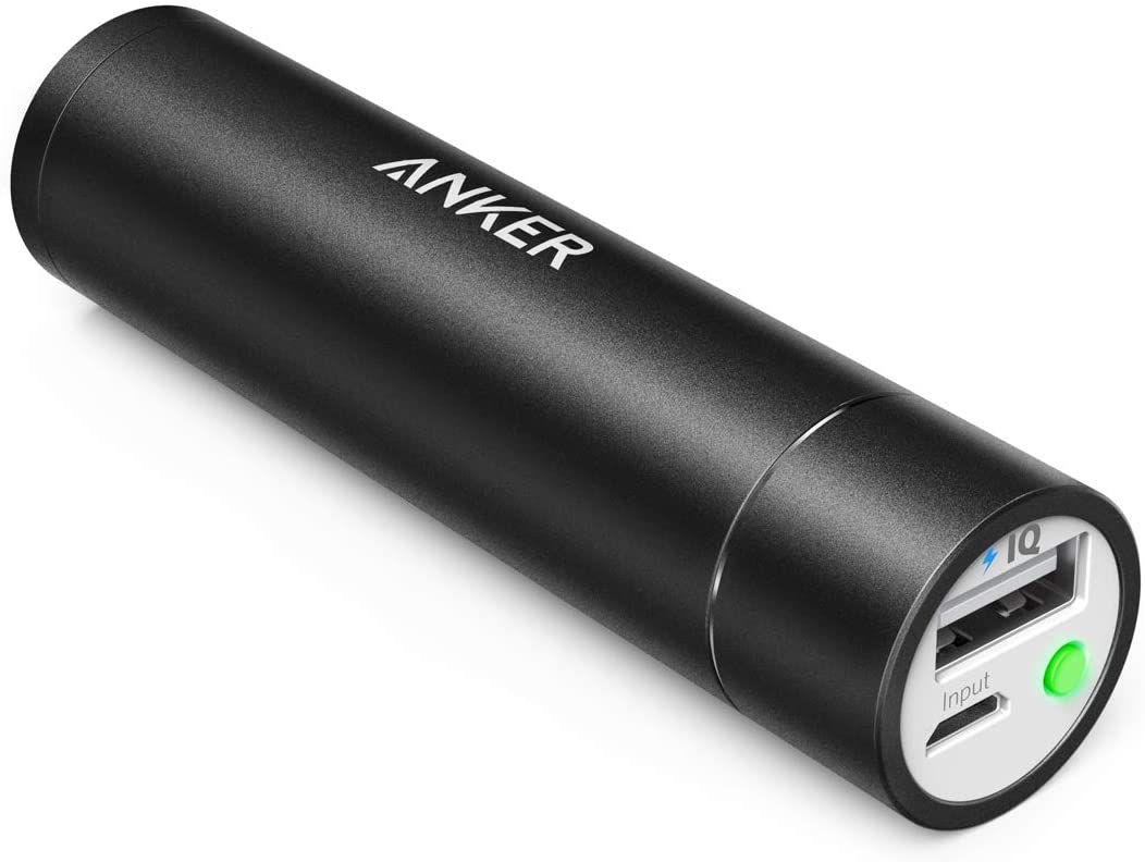

You could try one of these 5V power packs:
with a short cable:
I have an Anker 4500mAh one and it powered a Teensy 3.0 and LPD8806 strip of 32 pixels at a low (~25) brightness level for 8 hours, and there was still battery left.

Re: phone charger power bank:
Oh yeah! That!
For what it’s worth (possibly nothing), that’s a pretty inefficient battery setup. The boost from the native 3.7(ish) volts on ‘phone charger power banks’ is relatively ineffiencient-- because mostly: who cares how efficient it is as long as it charges your phone?
On the other hand, it’s dead simple to buy and integrate and use. It just winds up being physically larger for the available power than a ‘native’ 3.7v solution.
I also love the DF Robot boost module; much more efficient than most phone chargers. A native 3.7v solution is most efficient of all.
