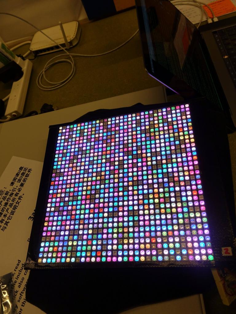

I'm looking for a high density 32x32 matrix, a premade 32x32,
I’m looking for a high density 32x32 matrix, a premade 32x32, not 4x 16x16 which I already have and the 16x16 panels everyone seems to be selling are just too big for my use.
Basically I’d like 32x32 that can fit on or under my shirt.
Exactly like http://www.themeu.net/ but with 32x32 instead of only 16x16 or 16x32.
I’ve just really struggled in finding higher density arrays, and yet, they exist, I’ve seen one in the wild from a limited run that I can’t buy sadly (picture below)
Does anyone have a lead on where I could get that?
Most of the HD pixel displays i have seen online have been RGB arrays(driven through their own micro) not addressable pixels. Ray Wu on aliexpress has a few panels like this but they are not as HD as you would like
@Leon_Yuhanov I know the HD displays you are talking about, they are used for signs and need an FPGA or a very fast micro controller.
I have a panel on this picture in the lower right, it’s 32x16 and 32x32 would be fine with it, but it’s just way too thick, not ok to stick on or under a shirt. Also, it’s a scan refresh array, it definitely requires non trivial work to update and that would be incompatible with doing infrared reading, which is also interrupt driven.

I found one 32x32 that’s not available any more:
https://www.tindie.com/products/robogeek78/flexible-led-array-32x32-ws2812-ws2813/
30*22 is one of the largest I found:
http://s.aliexpress.com/amuuIRvQ
@Stefan_stelb_Le_Bret merci pour les références.The sold out one is so totally what I needed. I contacted the seller just in case he gets some back or whatever, it’s a perfect match. The 22x30 sadly is just too small for 32x32 sprites, but it fits the shirt at least. If I find absolutely nothing else, maybe I can make do with it?
