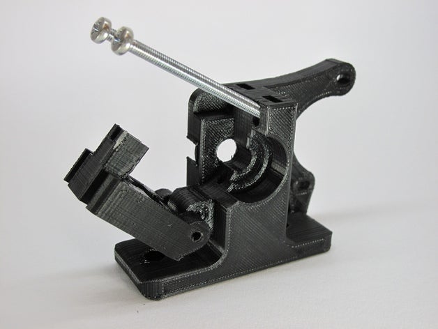

As suggested by Nicolas and as many people, I use Jonas Kuheling’s Greg’s Wade Reloaded because that’s what came with my Lulzbot. Lulzbot uses spring loaded screws on the idler and this works pretty well, but I hate that after pulling down the idler, I have to struggle to compress both strong springs while putting the idler back in place, and I loose the exact position and applied pressure they had on the idler… it’s a PITA. I was thinking of giving this one a try when I had the chance because of its “trigger” mechanism: http://www.thingiverse.com/thing:40642

Thanks, I’m printing the keuhling extruder now. It failed to attach on 2 of the bridges, and I had to repair it through netfabb cloud.
I might slice it again with support enabled.
What’s interesting is Lulzbot’s FreeCAD file for the kuehling extruder has support modeled in. But as I said the file should not be used for now because the history tree is shot. FreeCAD can be finicky…

I think all the hinged Greg’s variants have that little support structure built in for the idler fulcrum.Enabling support in your slicer might mean a lot of trash to clear out of the bearing hole that gets printed at the bottom, which I assume is why there’s that bridge support built into the model. Check the gcode before you print, you really want that first layer of idler bridge to be straight bridges from the body to the support piece. If they’re pointing the wrong way, you might be able to rotate it in the plater or twiddle some settings.
