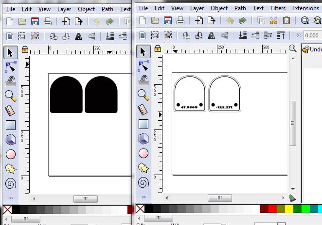

Thanks Justin! Worked pretty well for LaserDRW. I thought I’d post a few screen shots of what I did. Created first on Illustrator, next placed into Inkscape.On the left is the left is the cutting file on the right is the engraving.

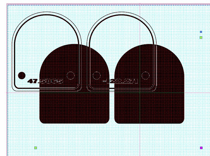

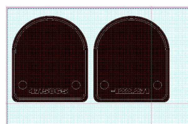

What is did next is opened up one of the two Inkscape files in LaserDRW and copy the graphic. Next I opened the other file in laserDRW and simply pasted it in.
The files were registered in Illustrator and Inkscape as well, but I find that they are a bit off, thus I pasted “layers” into Laserdrw. You can see that I’ve aligned them manually. Next, I cut the outline, or black shapes. To engrave, simply delete the cutting graphic and the engraving graphic is still registered.
