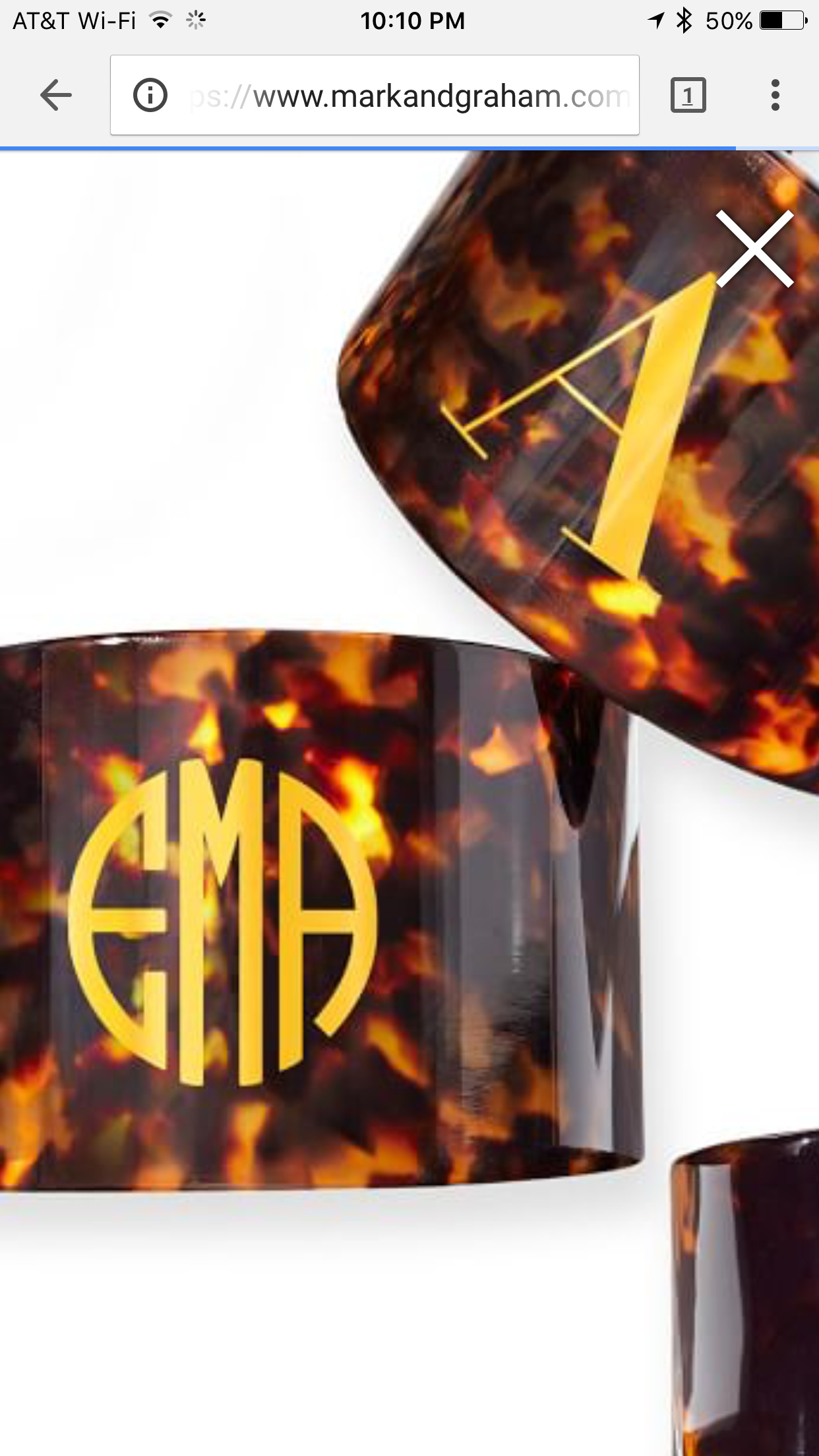

I used to manage the laser engraver/personalization depart for Williams-Sonoma I had them use regular masking tape then we would rub n buff or spray paint the lasered away tape this was on this acrylic bracelet
