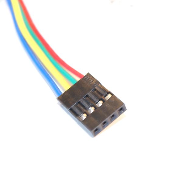

These or similar are the best motors Ive ever used:
I second @Brian_Evans suggestion. The Kysan motors have been nothing but a dream for me. While everyone else struggles with speed and torque, I’m just whistling away.
Good specs on that one, though personally I’d like to see a bit less phase resistance.
