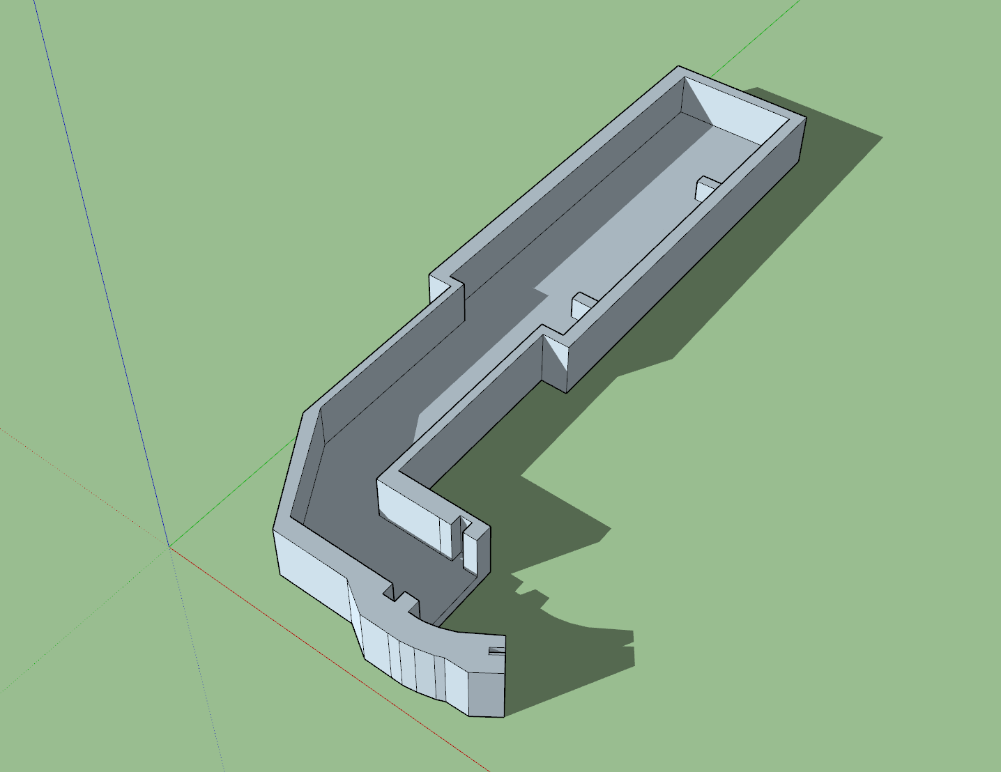

I'm not expecting this but I designed a model in Sketchup.
I’m not expecting this but I designed a model in Sketchup. And then I exported it as an .stl file and for some reason just came out as a weird result when I opened it up. (_ ?)
So can someone tell me what is going on? Does it have anything to do with the version of Cura?
I agree with @Nathan_Walkner I used Sketchup for a little while and only was able to produce 1 or two working .stl files out of it. Since then I have switched to Inventor 2017 and have never had a problem
I just heard there was an extenstion warehouse. There might be an extension good for that.
@Nathan_Walkner Well nevermind. I got one from @BEN_3D . That video helps. According to his video, it said an extension called Sketchup STL (mabye called that).
It’s been a while since I used Sketchup so I don’t know if they are needed or even work anymore but I recall that some extensions made the models/stl’s usable for 3D-printing;
http://extensions.sketchup.com/en/content/sketchup-stl
http://sketchucation.com/forums/viewtopic.php?f=323&t=22920
http://sketchucation.com/forums/viewtopic.php?t=30504
My previous tool chain was sketchup + netfabb + slic3r. Sketckup generated stl files are never manifold, meaning full of holes. I replaced sketchup by fusion 360, and i never had to use netfabb to fix stl, other than to rotate the output before slicing
