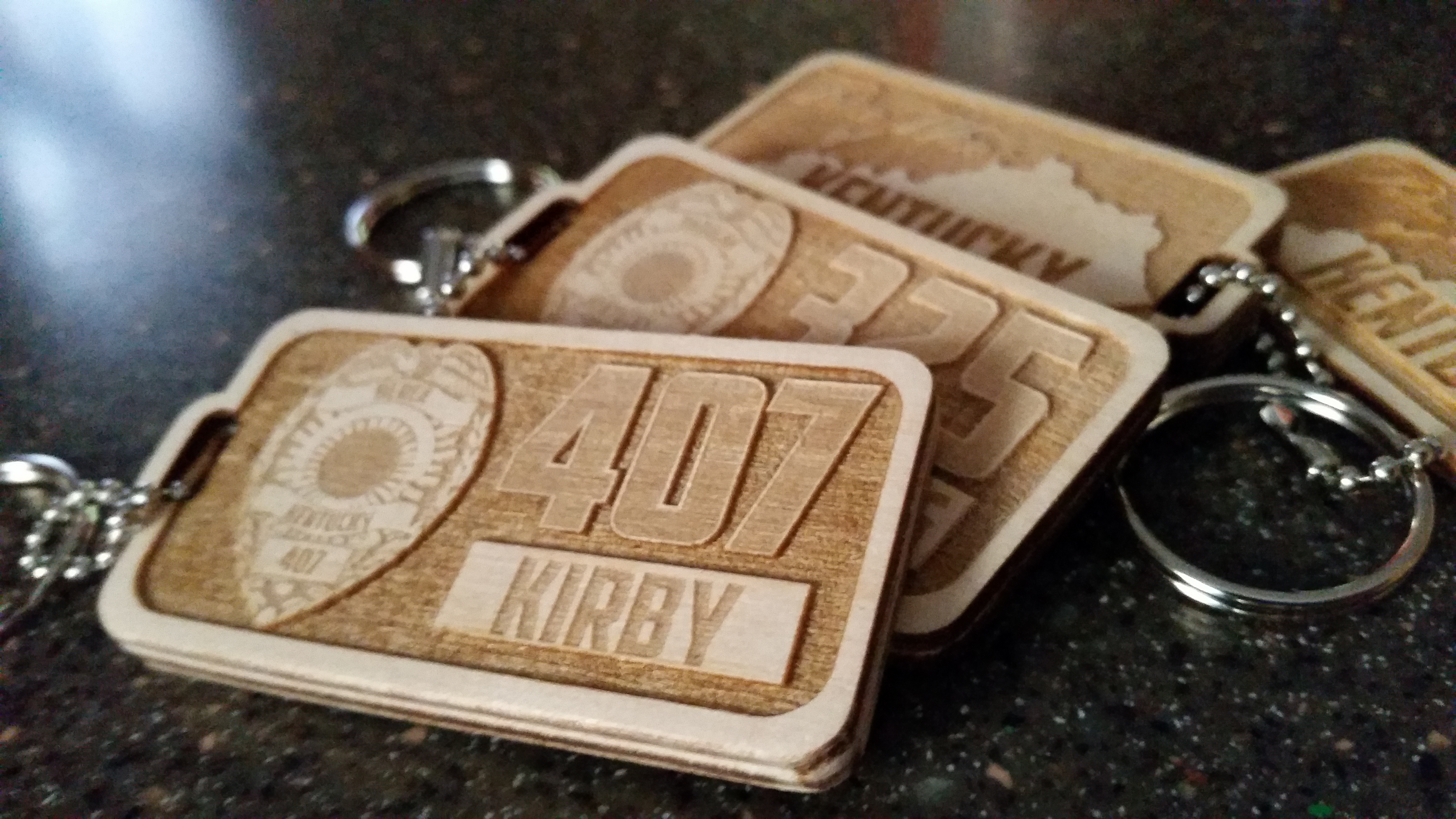

I’m not going to underestimate this K40. I have been fielding orders for these little keychains. So far I have sold enough of them to purchase several upgrades and I am just hitting the ground with it. The quality of the cut, along with a little tinkering with the software had learnt me many lessons. Maybe I was lucky or something but I have few complaints from the cutting software. I don’t design in it. I design on a more modern software and then export to wmf, do a few modifications and then it is off to engrave and cut. These keychains take about 10 minutes to customize and convert. Less than 10 minutes to engrave and cut. 1 minute to clean up and glue. They are selling for $10 each. So the K40 is the 10-10-10 robot in my book. Much less frustrating than the 3d printer in the corner.

Wow, those keychains look awesome. You did the whole thing with your K40? The material is plywood I guess?
1/8 inch birch. I cut both sides at once and glue them together using Gorilla wood glue. Then I use a matte finish to keep that fresh wood look. Of course this is a double engrave (different thickness) at 350mms and one cut at 10mms.

@Michael_Schroeter_Mi I design in illustrator (sometimes photoshop) but there is no hairline lines in illustrator so I have to convert all my cut lines in CorelLaser before doing the cut. not a big problem but the software that ships with the k40 is so outdated I just can’t wrap my head around. maybe adobe has spoiled me. And of course I got the two year warranty with the k40 - the glowforge is 6 months. I hope it doesn’t turn into a white elephant. If it is 10x better than the k40 I will be on top of the world because I am highly impressed. Did I mention that already?

@Michael_Schroeter_Mi I will send the file when I break for lunch and can get to my studio. I am actually at my daily grind today. :-). It’s a really simple rectangle. mirrored
