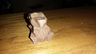

I'm not sure what do do with this please help! (I'm fairly certain its
I’m not sure what do do with this please help! (I’m fairly certain its a hardware problems, z axis maybe?) Poor cyndaquil is squished at the top and slowly shifts on the x axis as it goes up. The overhang it pretty bad even though everything is calibrated and the belt are pretty tight.
Z axis binding would be my best guess.
Check the set screws on the pulleys for the X axis too, make sure the drive pulley can’t slip on the motor shaft.
True, thanks
Check the x motor current setting on the driver. If it’s low you may be losing steps in one direction.
