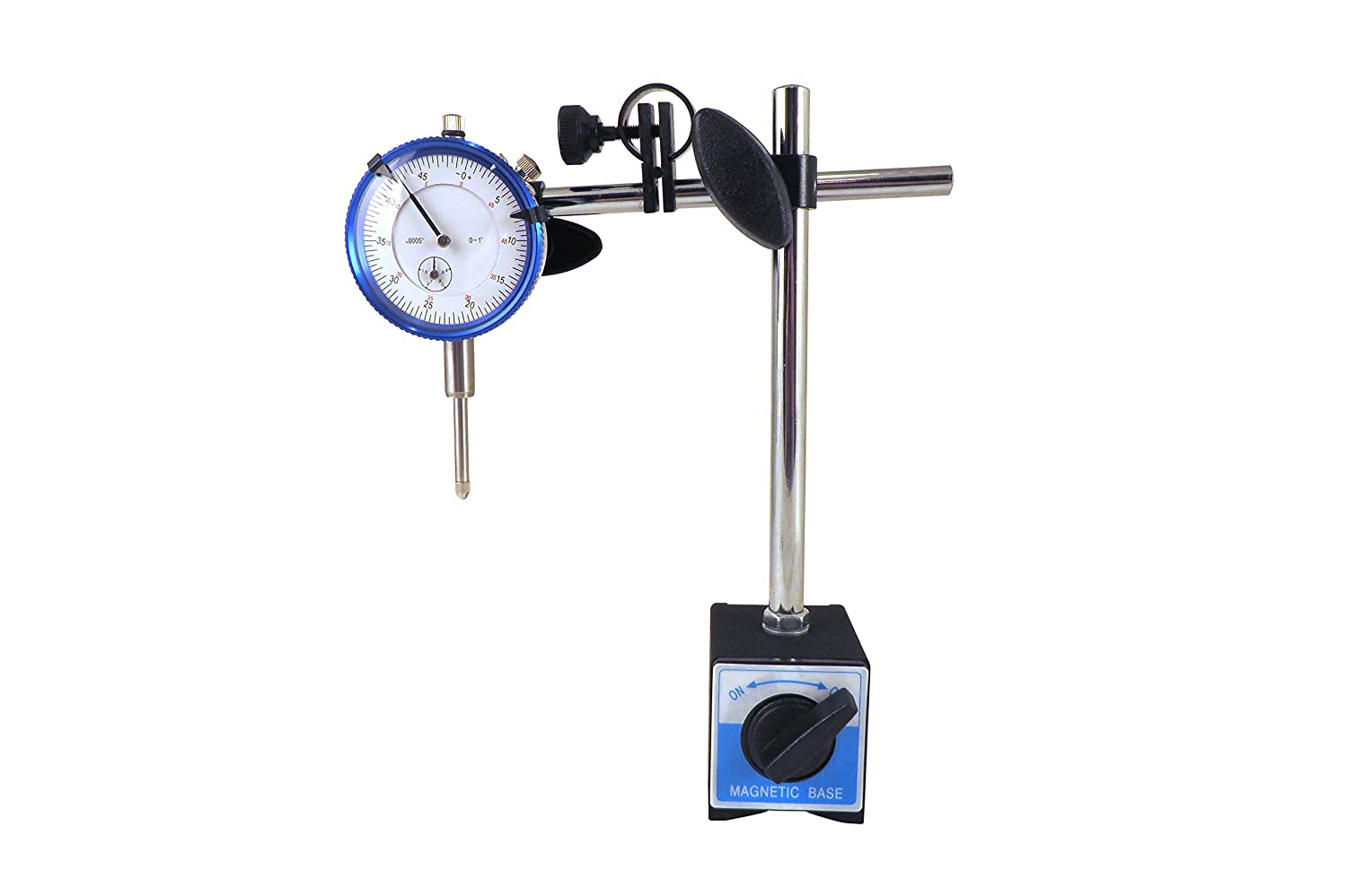

For calibrating Z consider using a 1 inch dial indicator. A cheap $20-30 one should be fine for hobby work.
Yeah that’s a handy tool to have, can use it for all your axis’. Also nice for checking for high or low spots on spoil board
