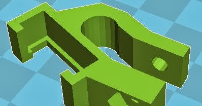

So I found out one of my i3 sets is from here:
Is this guy here? And is this the latest set of parts listed that he talks about in blog?
yes @John_Ridley is here.
And those are prusa i3 parts but i recommend the openscad files on pure customization. John’s parts are modified, not the originally parts and may be slightly different for your machine.
The fact is, it is so much easier to plug in your own parameters into the openscad files than trying to adapt your design to fit someone else’s parts.
