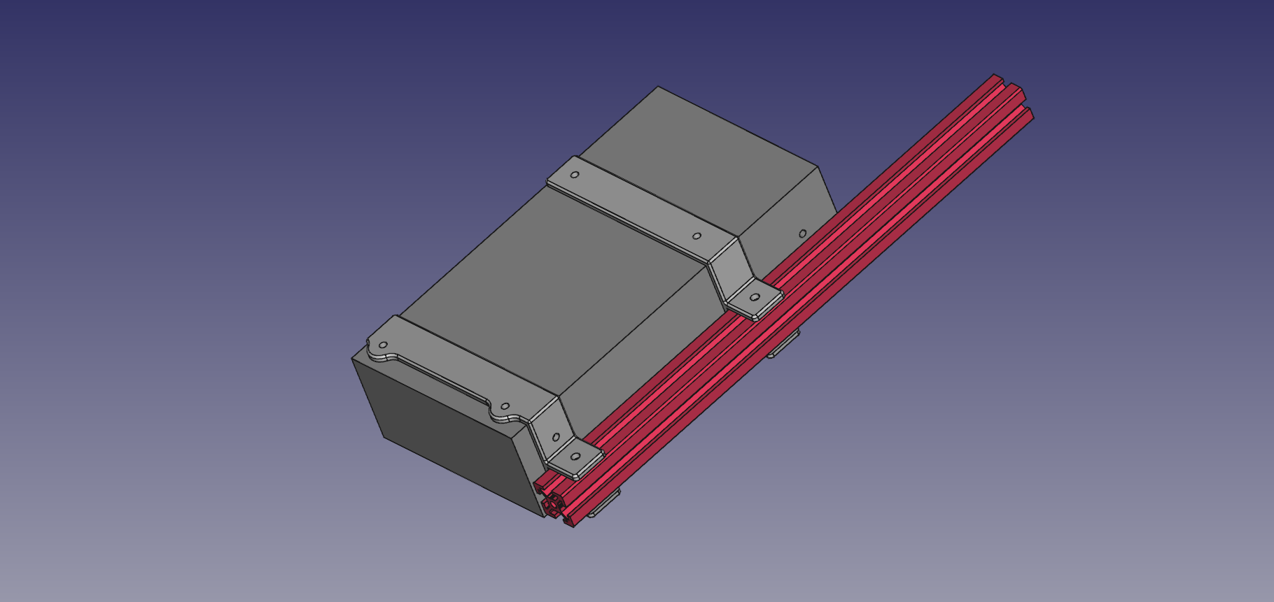

I’m really falling in love with FreeCAD as a program. about an hour 1/2 and I’ve put together a PSU Mount for the 20A PSU on the FB2020 Plus… Whether it works or not is a different matter. Better get printing…

@Chris_Rennie - That’s what I was using previously. I found it a little limiting, without using the maths programming to sort edges and the like out (my maths is horrendous, so alot of things like sin, tan and cos go over my head) and the programming took a lot longer than it does to put things together in FreeCAD for me. Don’t get me wrong, Most of the FB2020 is actually designed in OpenSCAD, but this actually works better for me.
