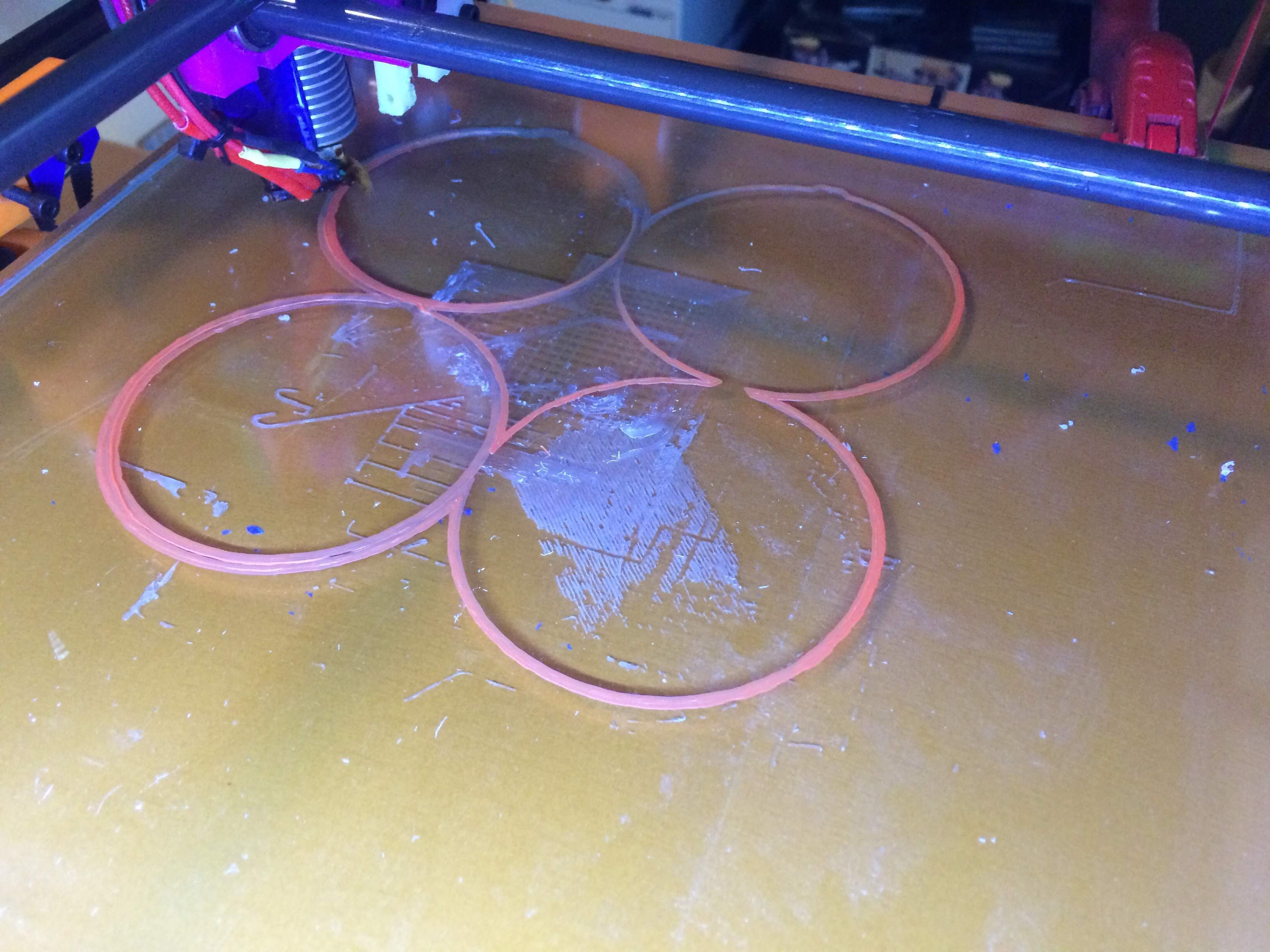

I'm really liking 1/4 inch window glass...great surface quality, good thermal properties,
I’m really liking 1/4 inch window glass…great surface quality, good thermal properties, nice and flat. (This is 160 mm^2)
I’ve got pieces that I swap out between prints when doing production parts. Any surface prep you need can just wash or peel off when you use different filaments.
I’m having great luck with hairspray and 90C on glass…nice thing about hairspray is that it’s a water soluble layer.
So is PVA for use with nylons
