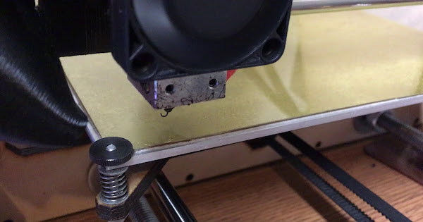

OK, using a value of 4 fixed it. Tried to print something and its doing something new with the homing. https://photos.google.com/share/AF1QipNaYxb1uNYHlORDYX4MGIDVJe6G6ifhwXmRGVfFMbsOVKVjvMnREBTjj6V0XETI-A?key=RFZjUWpWVXp4YVFENW9za2tyWml3Z3lvRGNiLV9B
Not sure what I’m supposed to see, that looks normal.
OK, I think I must have had it homing each axis individually then. It appears to be doing all at the same time. Thanks for helping me get updated! Now on to updating Slic3r and Repetier.
