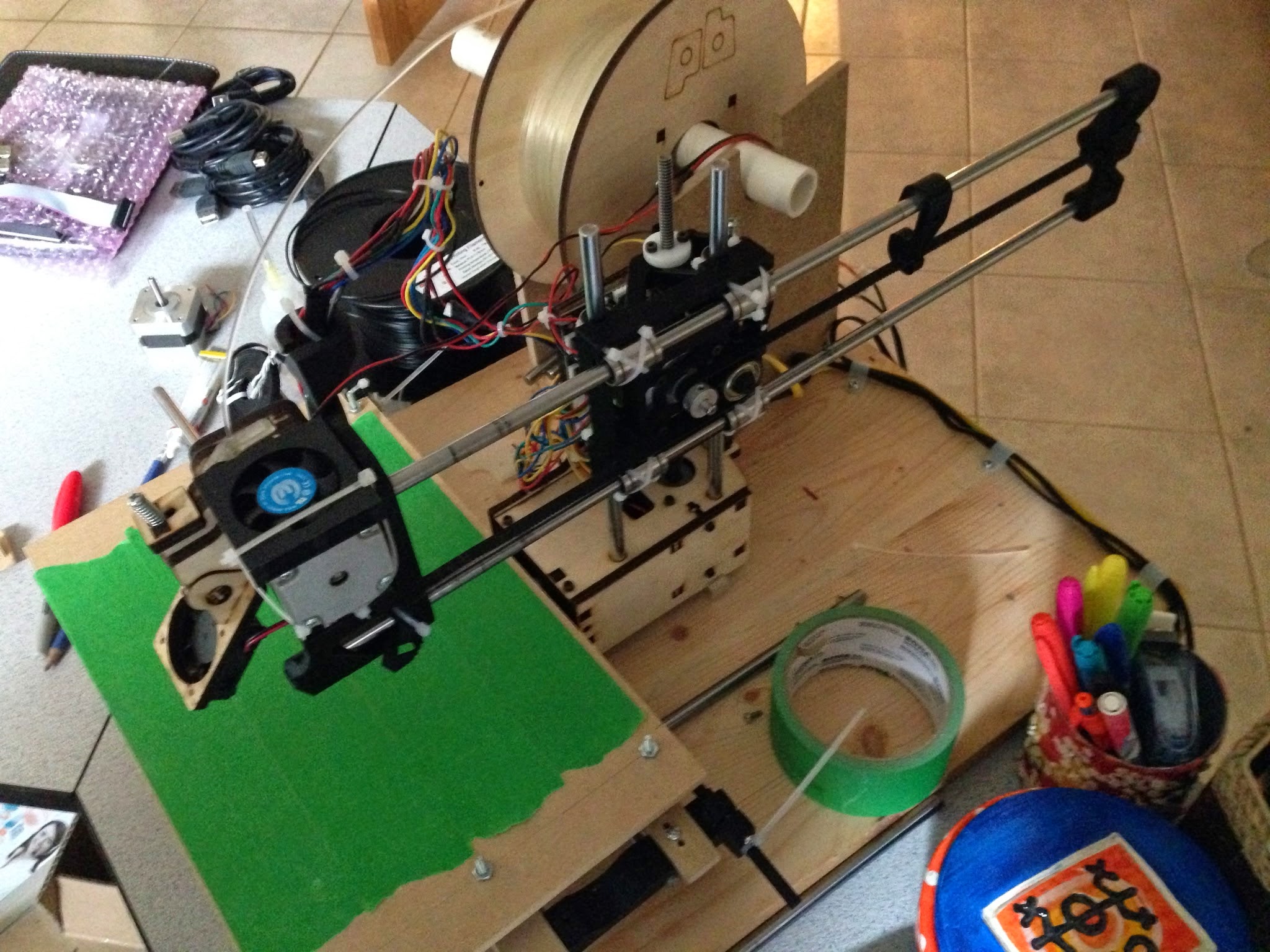

I’m running a @Printrbot Simple upgraded with the X and Y extension from Thingsverse. Prints are amazing. However I’m getting a LOT of vibration noise on the Y axis. If I reduce the speed the vibration are less, but still present. Any ideas on how to reduce the vibrations?
I’m not familiar with these printers specifically, but I wonder if you could put a layer of cork between the motor and the frame.
@Mike_Miller I think there is clearance enough for that. So you think the vibration would come from the motor and not the belt ?
@Andre_Courchesne1 I had this problem with the Y axis upgrade at first. Mine turned out to be the belt rubbing on itself where it doubles back near the motor. Make sure your belt is quite tight, or it sags and the teeth rub each other.
Other than that, I’d suggest lubrication of the rods, maybe?
