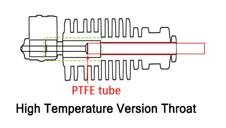

I’m using the XCR3D XCR-BP6 high temperature hot end. I had inserted PTFE guide tube as far as I could into the top of the hotend. I kept having problems with jamming, though. I finally realized that the PTFE guide tube that shipped with the unit was slightly narrower in OD than the PTFE guide tube I already had on hand, and switched to using the right guide tube. Now I notice this diagram, and it finally makes sense. It hadn’t made sense when I was using the wrong tube.
Don’t be like me, use the right OD guide tube.
I believe this is why I’ve had trouble printing about 100mm/sec when this should be able to go a lot faster. I had inconsistent under-extrusion and jamming when I tried to go faster. I’ll have to try again now. It could make a big difference in how fast I can print face shield frames.
