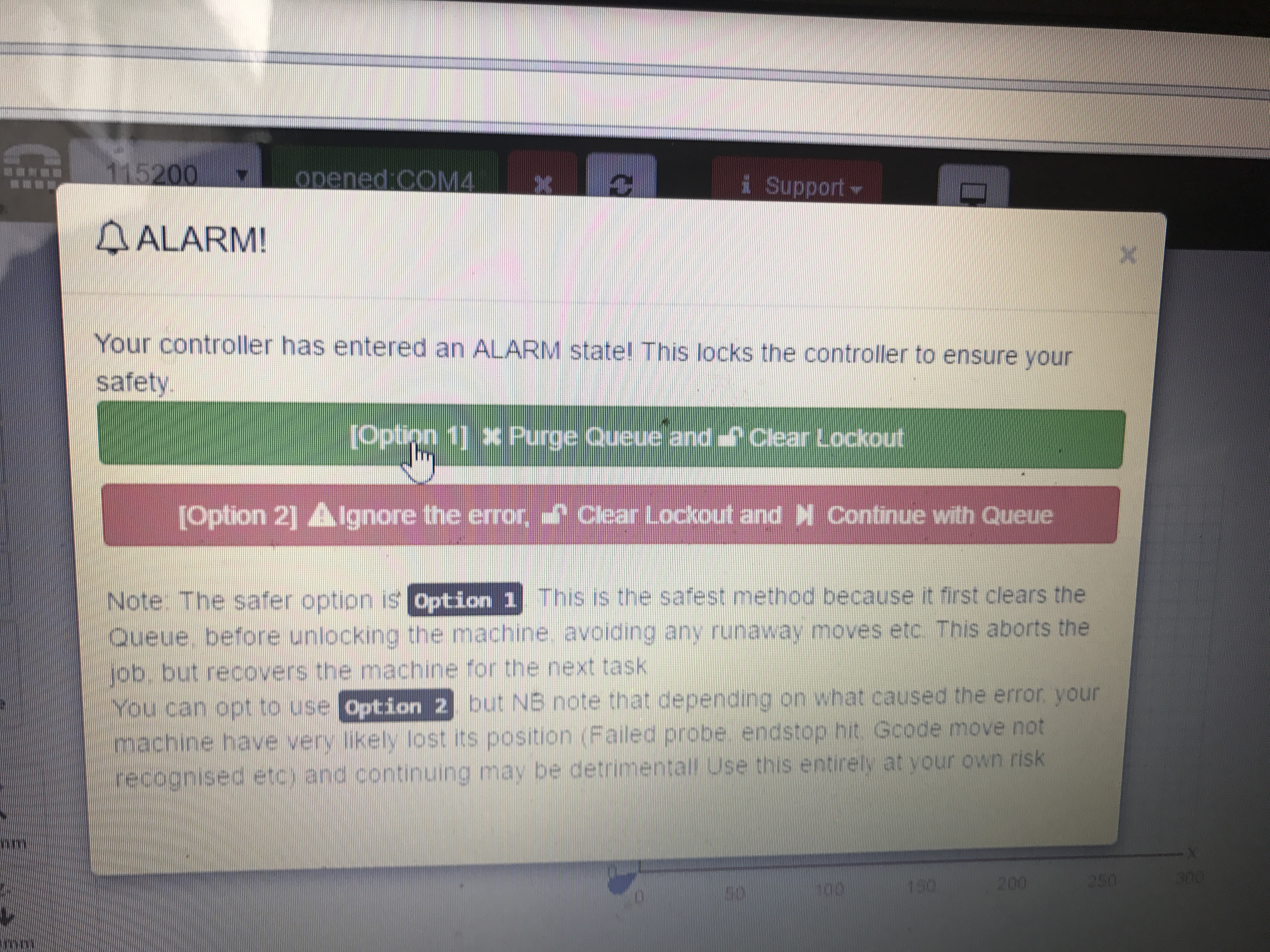

I done LaserWeb3 upgrade to latest version and now when i connect have something like this
I never had this before

The only time I see this is if I hit a limit switch or some other means of interruption that puts my smoothie in alarm status. LW is now giving you a way to clear it from the UI without having to reset or in my case historically Iād use my GLCD to reset the error state.
@Damian_Trejtowicz ā not a board issue, is just LW issuing a alarm. This also applies if you stop the process in the middle.
When i press option 2 machine is cutting fine,no problems at all.
