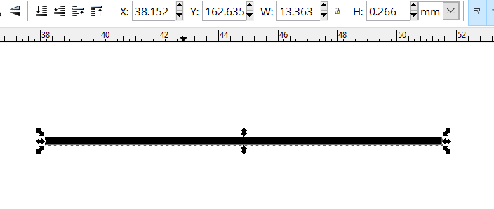

My typo gave me an idea for a test case:
Lol. Can’t work out how to attach a file, but here’s a link. https://1drv.ms/u/s!AvGqua9bVBe66TOMedGOHbTdtoU2
Inkscape:

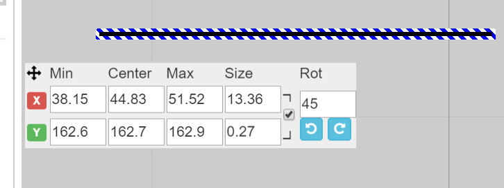

LW4:
