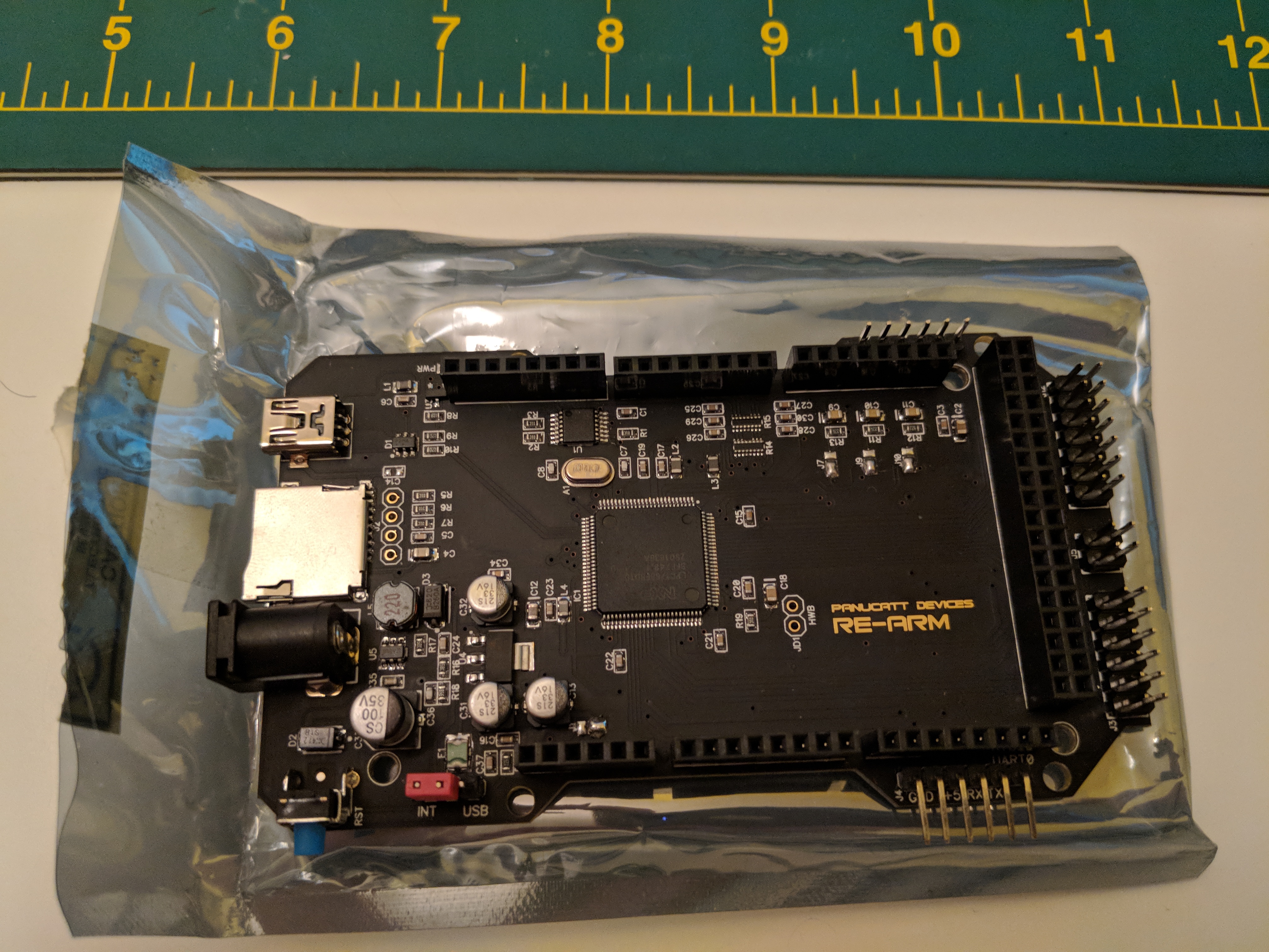

I'm starting to set up my re-arm board and I would like some advice.
I’m starting to set up my re-arm board and I would like some advice. I am currently using Marlin and my homing routine is:
