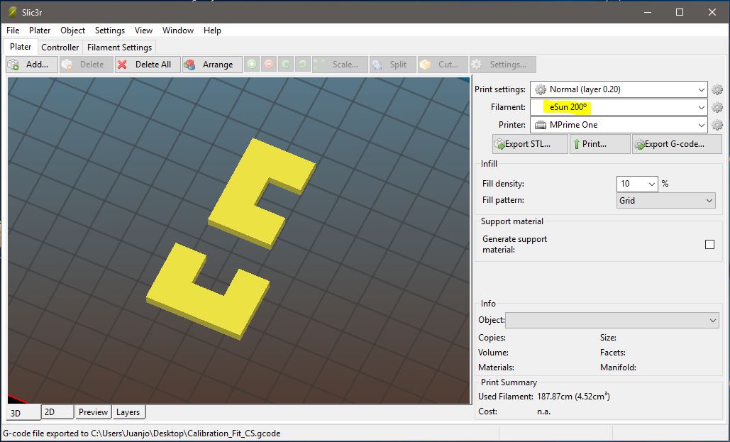

This is the Slic3r general screen. My eSun 200º profile is selected.

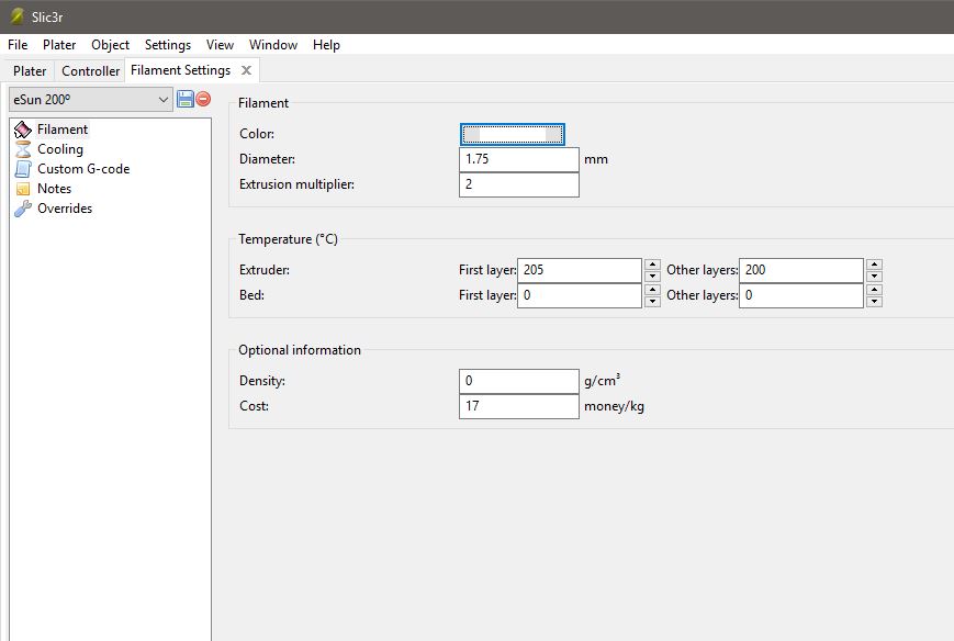

With the amount of compensation you are having to make in flow without resolution I’m suspecting something mechanical. Possibly a restriction or something slipping. When using the filament diameter adjustment on the clips it should not stray beyond +/-0.15mm in measured diameter. That equates to about +/-15% flow.
Try a little of the old filament or at a slower speed and see if anything changes.
Even though I said to go ahead and try 300% flow, tht was only because it seemed your slicer profile might have been set up wrong. You showed us clearly that it was not and there should be no problem there unless Slic3r was ignoring your profile.
I agree with the idea of no more than a 10% flow adjustment during normal use.
