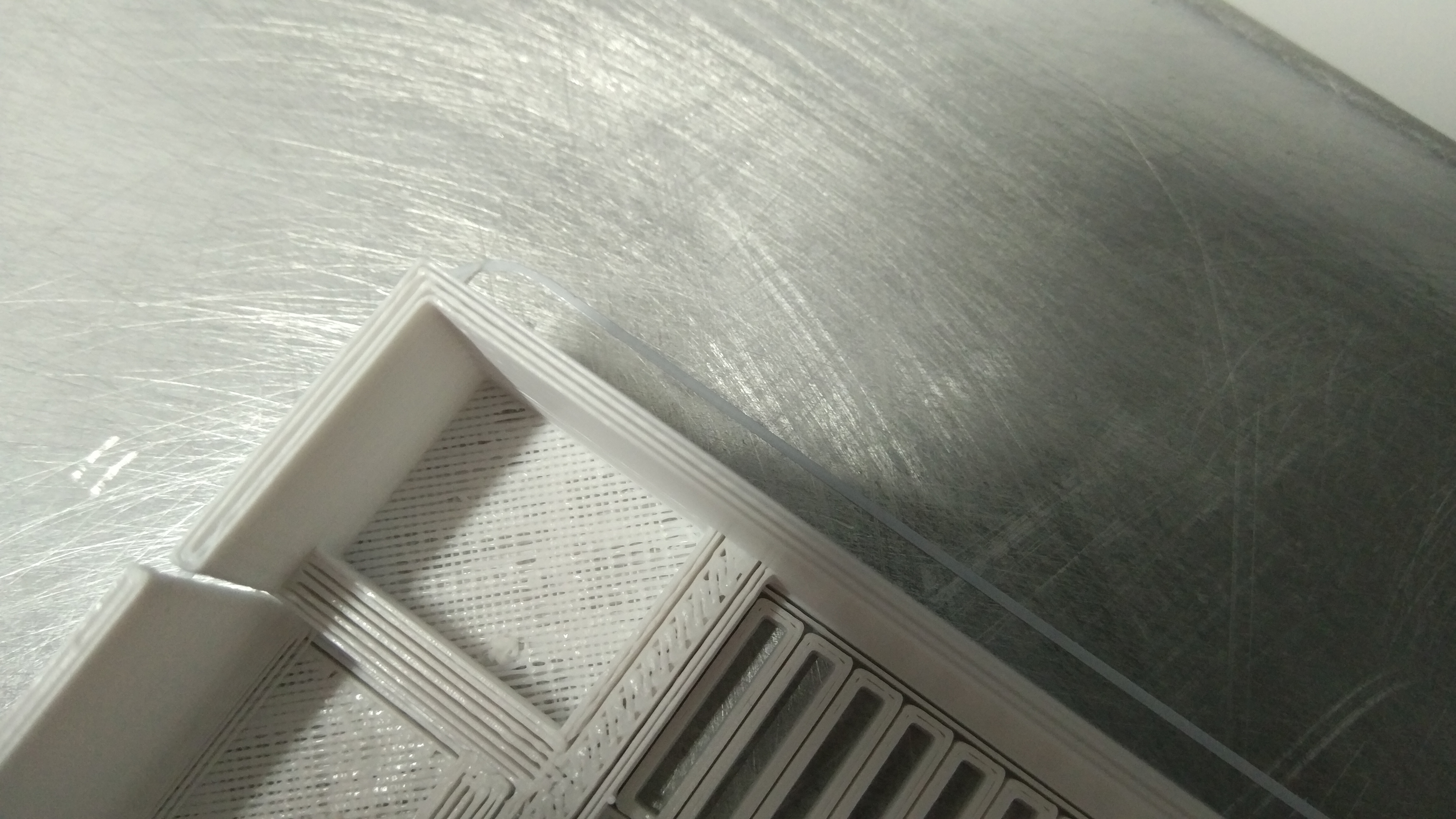

But, I don’t know why the printed walls are very weak. I’m using the same print parameters as used with my previous filament, which generated a good print.
But now, walls are not “fused”. You can see 4 fine walls and very weaks instead of a one solid wall.

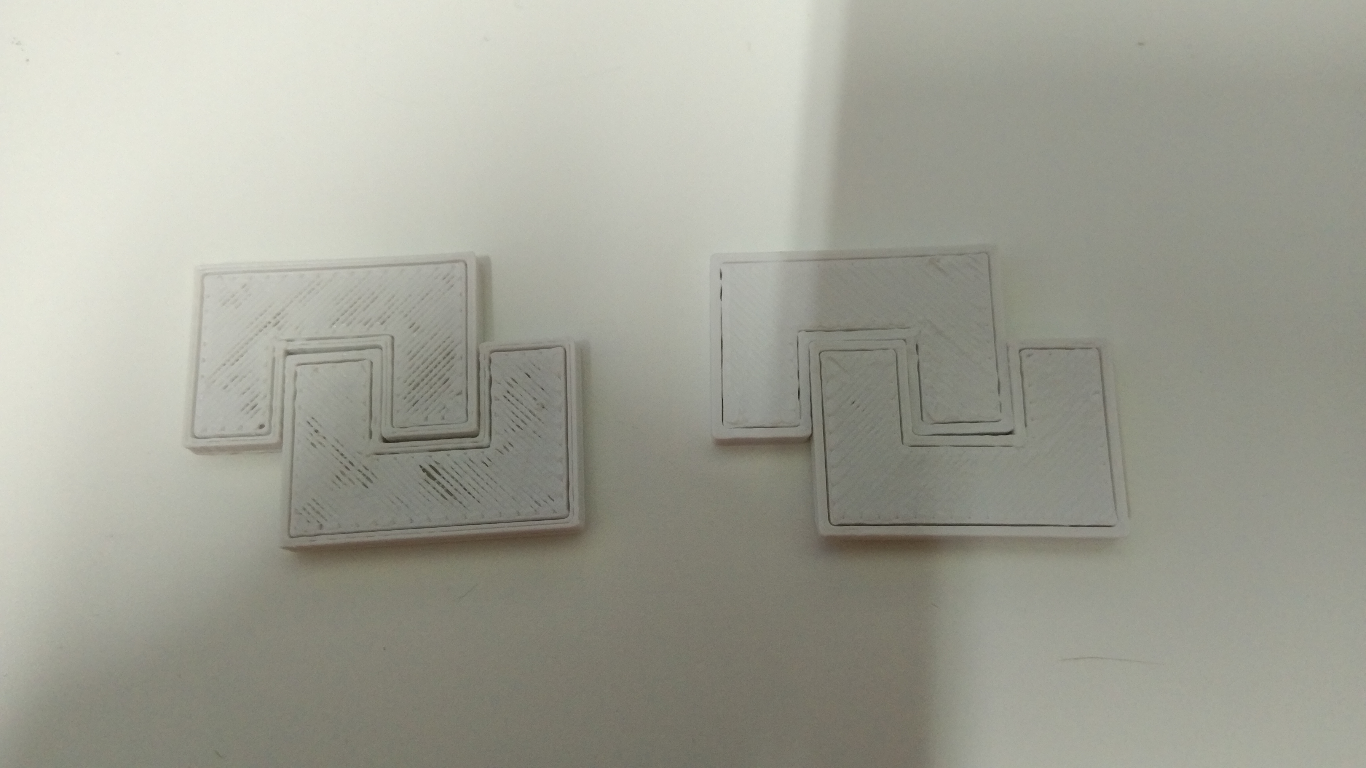

Thanks for all suggestions and comments. I don’t have a caliper to check filament’s diameter. So, I started a trial&error test.
See the attached picture. Left is about 1.5 flow increase, still bad. Right is 2 flow, so 200% increase in flow. Still not good, outside wall is not fully connected. I don’t know why.
I’m trying to print my piece with this 200% flow increase, and is still not good. Walls are more fused, but there is still not fully connection like test pieces
Should I still increasing flow ?
