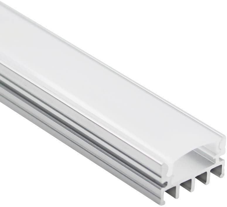

Mounting is an issue. Posts cast shadows, but a frame is probably your only solution. Either channel as you have muted or cut a slot in the frame material to hold your sheet as you put the frame together. Or just screw/glue directly onto the frame. Make the back with the LEDs mounted on the removable panel for servicing.

The biggest issue I ran into on a previous project was figuring out how to support the center portion of the plastic piece without the support being seen. On my first project I used a frame and that worked okay. I might do that again here. There is one thing you said though that I don’t understand. You said “channel as you have muted”. What do you mean by that?

@Dave_Morgan in this context (and actually it was not you, but Michael), I was combining two comments of the acrylic sheet and the aluminium channel from the top of the comments. ‘Muted’ means not expressed openly or strongly.
So I was combining all the information and forming a unspoken conclusion. Sorry, muted is not a very common term these days.
