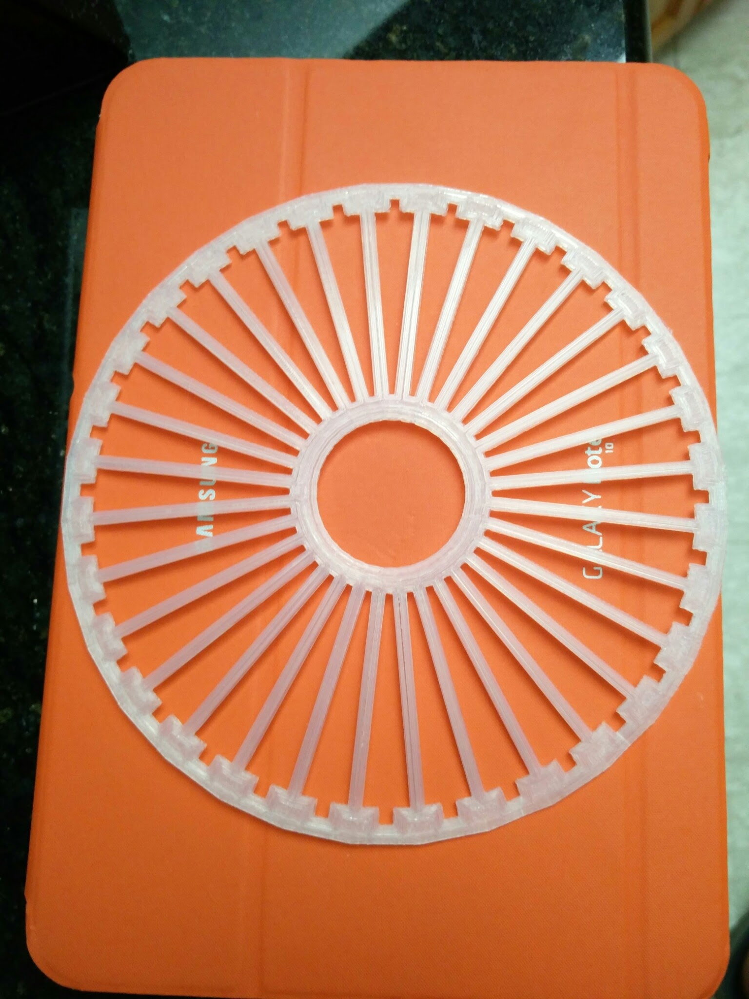

I'm struggling getting PLA to stick. I'm trying to build a ceiling lamp shade.
I’m struggling getting PLA to stick.
I’m trying to build a ceiling lamp shade.
After about 2mm thickness, it gets unstuck.
It’s due to warping…
I tried blue painters tape, but the take gets unstuck from the glass.
Also tried printing directly on the glass with hairspray.
No heated bed yet. Any suggestions?
I don’t want to add brims due to the finish quality.
Galaxy Note for reference of size…
