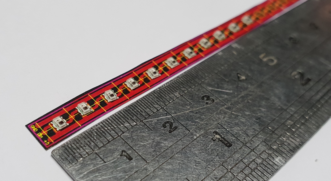

Im sure some of you may seen these new WS2812 2020 Pixels http://www.world-semi.com/DownLoadFile/139 I have been trying for the last several months to get a big company to fab these, but no one is really biting. So i decided to take matters into my own hands. I started a Kickstarter today https://kickstarter.com/projects/elecdashtron/ws2812-2020-addressable-led-pixel-strips to raise a tiny bit of cash to develop and fab these. I’m aiming to make these very specifically for low power wearable use. Hope you all don’t see this as spam, please let me know if you do ill take the post down

One thought, if you’re getting these flex strips custom made, why not make the solder pads bigger for easier soldering? (Assuming this is actually possible. I know it’s small!)
I’d love to see that strip (not just the pixels) in comparison to maybe the 90/m 2012 strips…what we can barely work with since the pads are so small…maybe if the pads came thru to the rear? (I know then that limits mounting, but a layer of foam tape would insulate)
How hard would it be to cut and resolder these? I already work with 3535 7mm wide strips for wearables, cutting and resoldering to make irregular shapes and although I really want smaller, I’m not sure how I would manage to resolder them. Would I need finer tip and a microscope?

I agree with @marmil , I know you’re size constrained, but the larger those pads are the better.

@marmil Im going to get a few different designs fabed. The one up there is 5mm wide. I have one that is 4mm wide with square large pads that go @Michael_Sime through hole to the other side. The 4mm strip is double sided, bottom layer is GND & +5v with each hole coming up to the top layer. @Franck_Marcotte they will ABSOLUTELY be cutable at each point, thats one of the main goals!

But as feedback, non flexible strips are not very helpful to any of my projects. Your build also looks like way too much space between the pixels. It looks like you could fit 3, maybe 4 by cm. The reason to get something that small is to have a very high density.

Re flex, these WILL be flexible(i also have 0 use for rigid strips). RE your assumption that more can fit it, I highly welcome you to try yourself and shoot the Gerber across. Ill be super happy for anyone contributions to this project and will fab up your version as part of the KS Campaign 1st prototype round(if it happens)
@Leon_Yuhanov could we see a side-by-side comparison to 60/90/144 existing strips I know personally I need visual aids, as I have no imagination whatsoever

For hardware design, it is indeed something I know nothing about, so while it looked like at least 3 LEDs could fit per cm (4 would be a stretch), if the router says it doesn’t work, I’ll take your word for it.

@Leon_Yuhanov yeah, saw that, I was more interested in the final spacing on the strip you’re proposing…do you have a photo showing your prototype with the spacing you’re thinking next to an existing strip?
