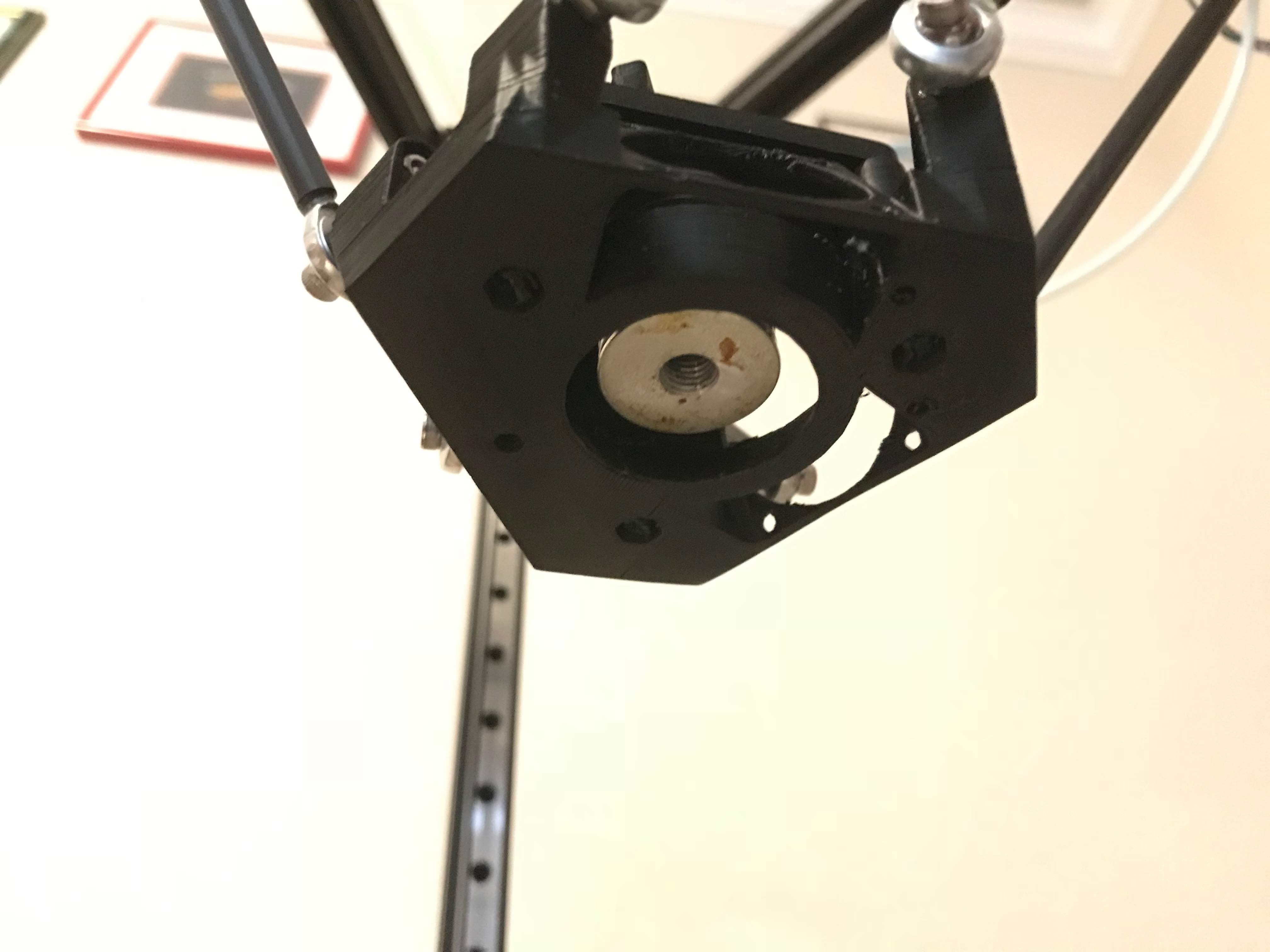

this was my never published prototype, unfortunately no leveling probe… it was designed to be fitted on geeetech g2/s pro effector, so not directly compatible with E3d but you could make additional adapter.
just as an idea :slight_smile:
@Marko_Novak that black tube thing is an extractor or cooling?
@Cristian_Nicola it’s ducting for cooling, there’s industrial 80mm fan on top.
there was so much airflow, that standard delta heater (140w) wouldn’t go above 80C.
thing was spitting PLA like champ.
but temp needs for ABS was just to much for then un-isolated heating block and bed with high thermal conductivity.
but if you can make ABS stick and reliably remove, on cold bed… this is it :wink: stiff frame mandatory.
