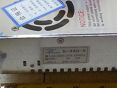

For AC, I gave away using wall warts in exchange for switch-mode PSUs. I bought 20 5A ones for under 5 bucks each, just need to wire up a power lead. http://www.aliexpress.com/item/25W-5V-Small-Volume-Single-Output-Switching-power-supply-for-LED-Strip-light/628334432.html

I’m also curious about reliable power supplies. I have now a 10A 5V powersupply bought on ebay/aliexpress. However it’s still a no-name brand. I don’t want to take risks if I deliver an installation to an external party. If something happens I’ll be responsible.
Someone pointed me to Meanwell as a affordable brand. However there 5V supply goes to 6A (30Watts): https://www.meanwell-web.com/en/products/ac-dc-power-supply/adaptor/26-100-w/gsm60b
I buy from Smun: http://www.smunchina.com/e_products/?big_id=1&small_id=28
They’ve got a huge range of PSUs
May not be as good quality as Meanwell, but they are only a few bucks. I haven’t had a single failure yet and I have tested 25 of them.
