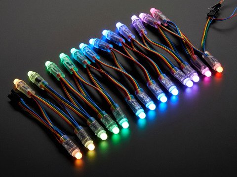

Troels, had you considered using something like these
Those are 3" apart, but there are ones available that are spaced further apart.
That would definitely be a good idea, but I think they are a little expensive compared to the led strips I was looking at. Being a poor student, price is important. :slight_smile:

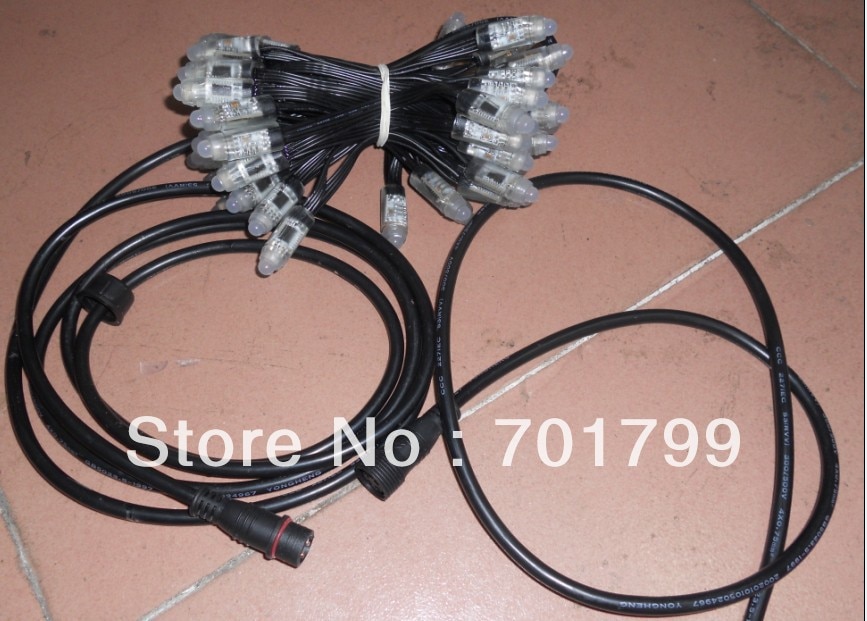

With most LED things on Adafruit you can go to the source (China) for the cheaper price.
this is double the LEDS for almost half the price
