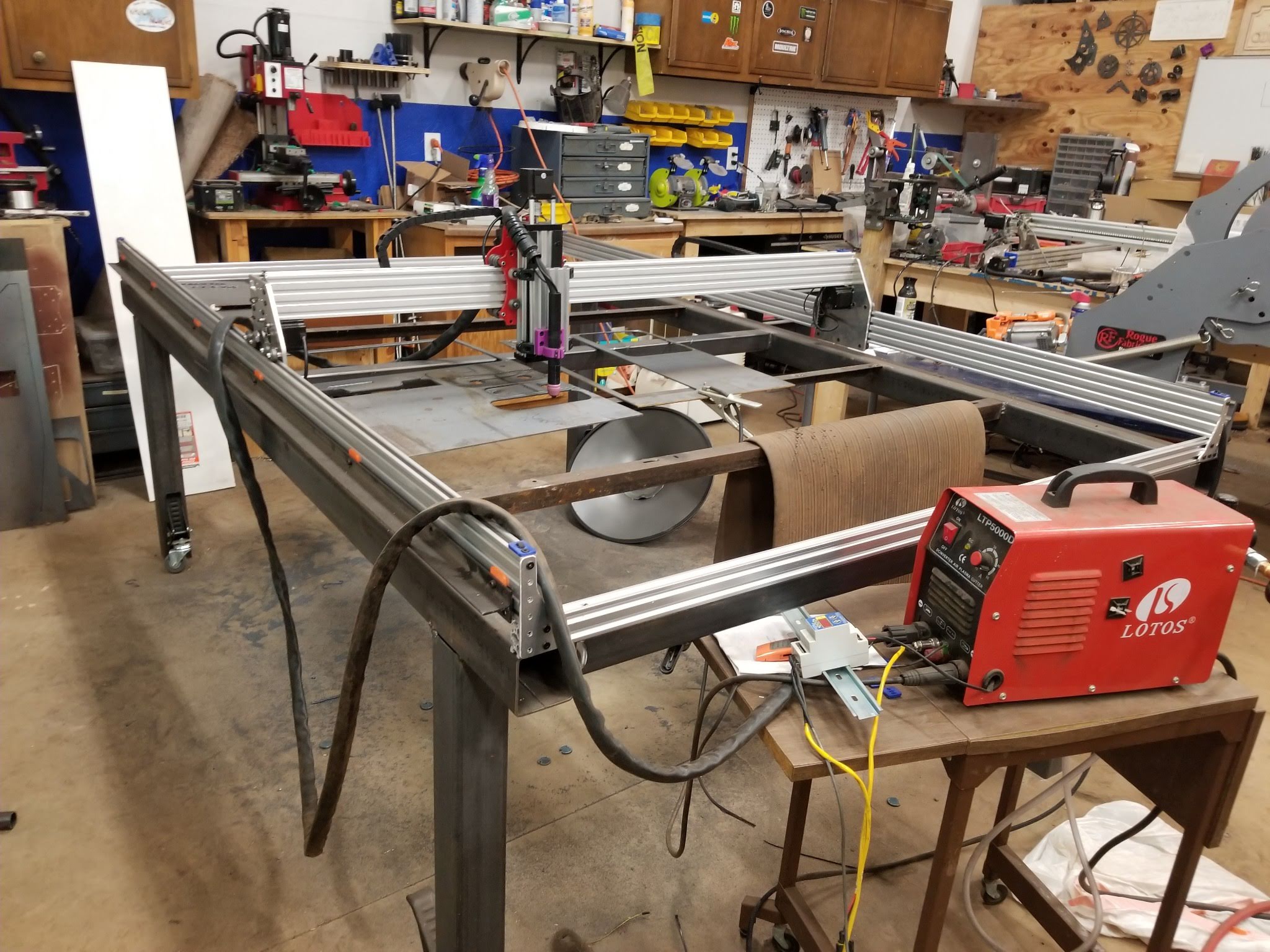

Hard to see in that pic, but it worked well in this application

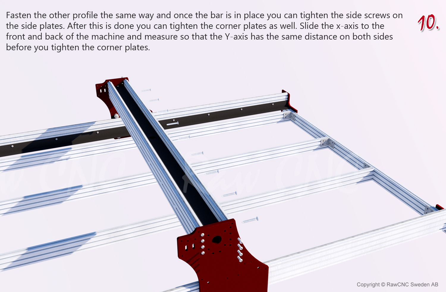

I saw that RAWCNC XL design also uses a square steel pipe between two aluminum profiles in the gantry for rigidity, and also for the longer axis uses angle steel.
@Fernando_Montes that’s pretty cool. Never heard of them before
