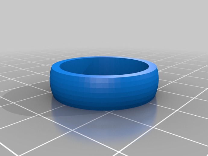

@Eclsnowman . this is what crowned pulleys are for.
@Dale_Dunn now if only robotdigg of misumi would machine them that way
A hand drill and a piece of sandpaper.

May play with a crowned idler instead of guide washers for the fun of it,
