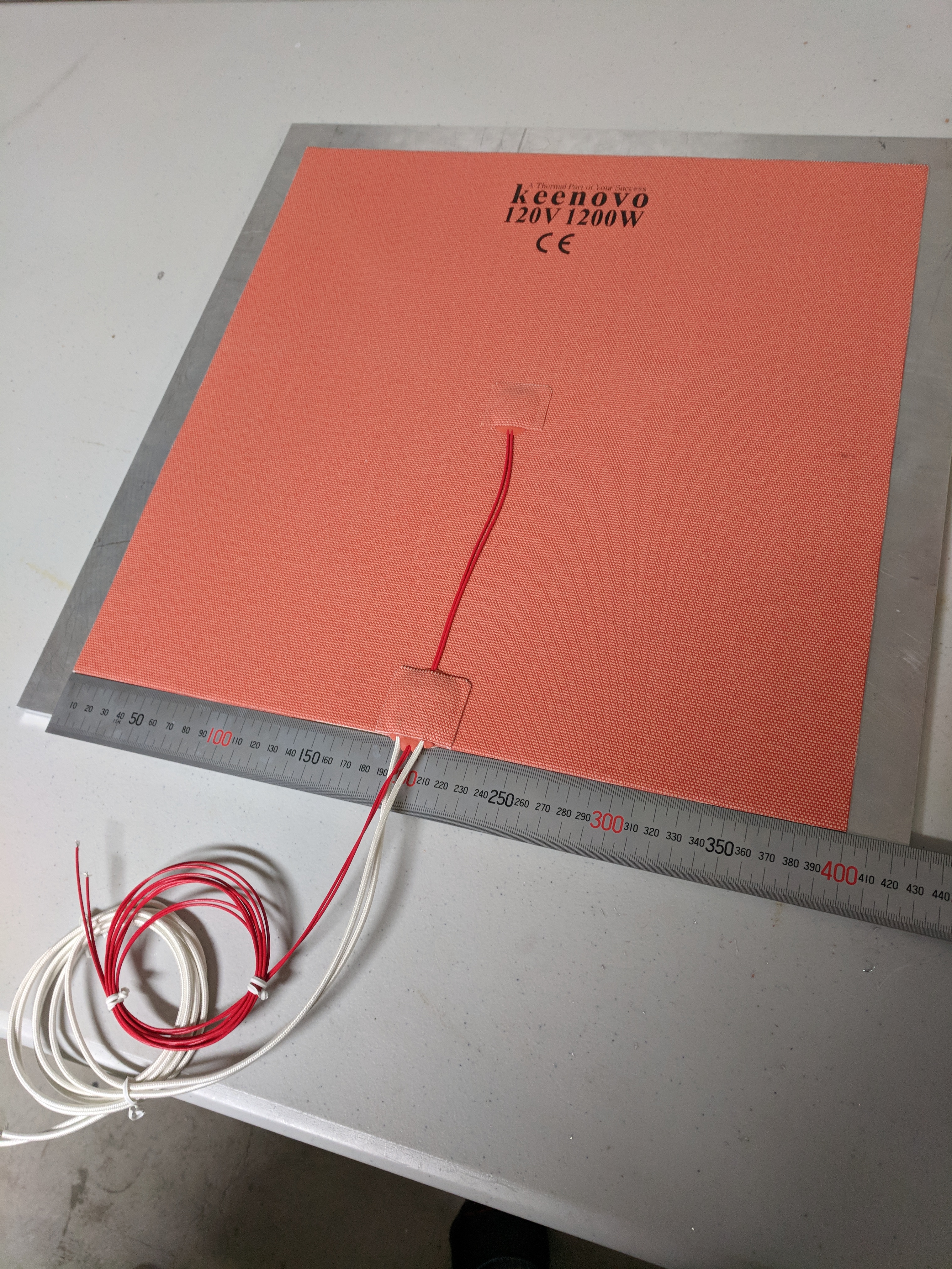

@mcdanlj Will admit some confusion, on this topic, in terms of process, alloy, and cost. Went through the choices months ago, and made my best guess. In the above picture I have a 450mm square aluminum bed with a 400mm heater. (The print surface is meant to be 400mm.)
Pricing the cast ATP-5 plate from MidWest, the same size square should be a bit over $100 shipped. The zinger is “flat within .015 inch” or 0.38mm … which is a bit large compared to layer height. Could get lucky. Or could need to flatten the plate, somehow. If I need to flatten the cast plate, is that still an advantage over less expensive sheet?
