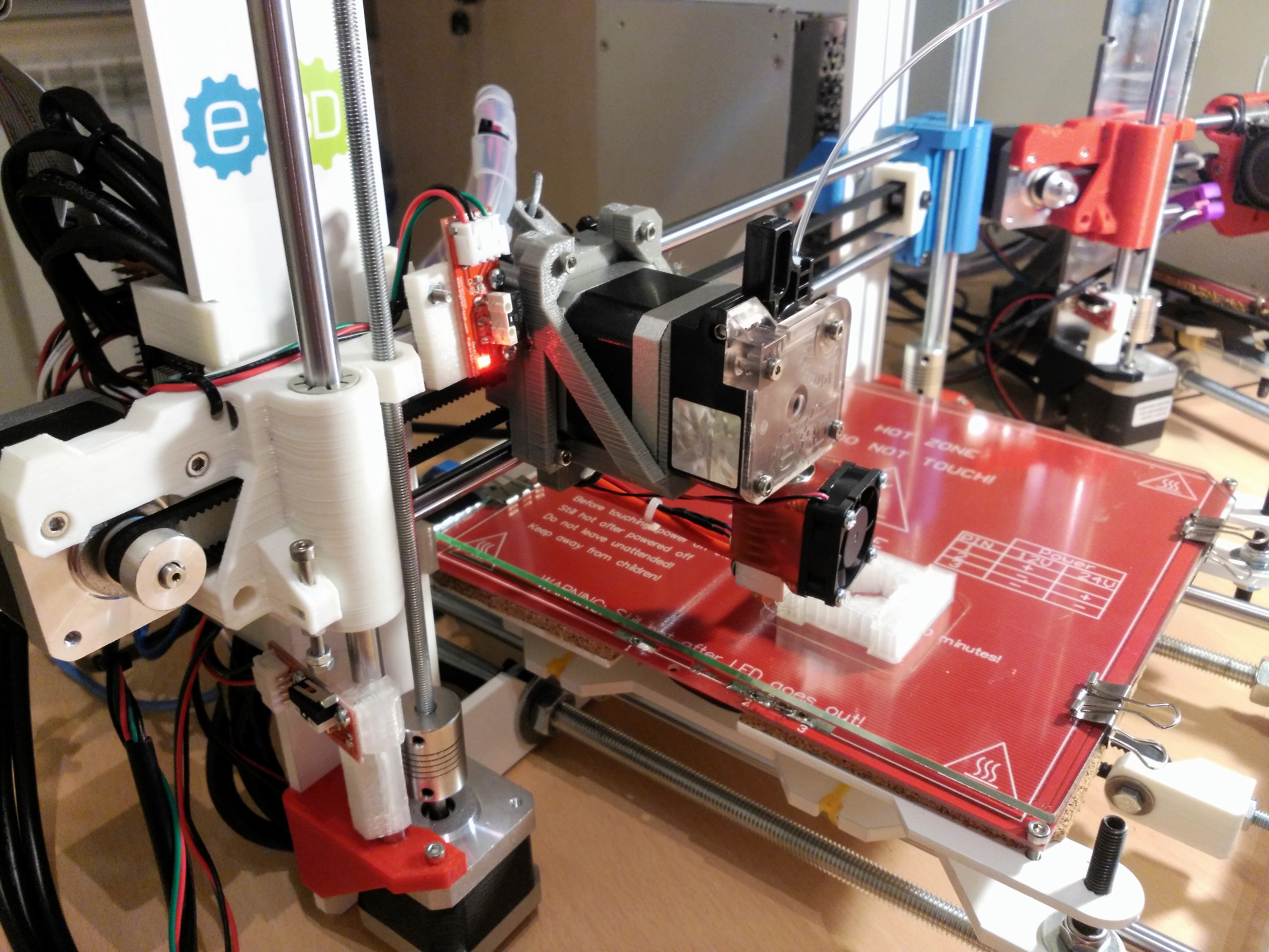

I'm trying Titan E3D-Online ​ with Nema17 motor 40 mm long with 1.75 filament
I’m trying Titan @E3D-Online ​ with Nema17 motor 40 mm long with 1.75 filament and goes perfectly, what will be the shortest Nema17 motor that can with 1.75 filament?
