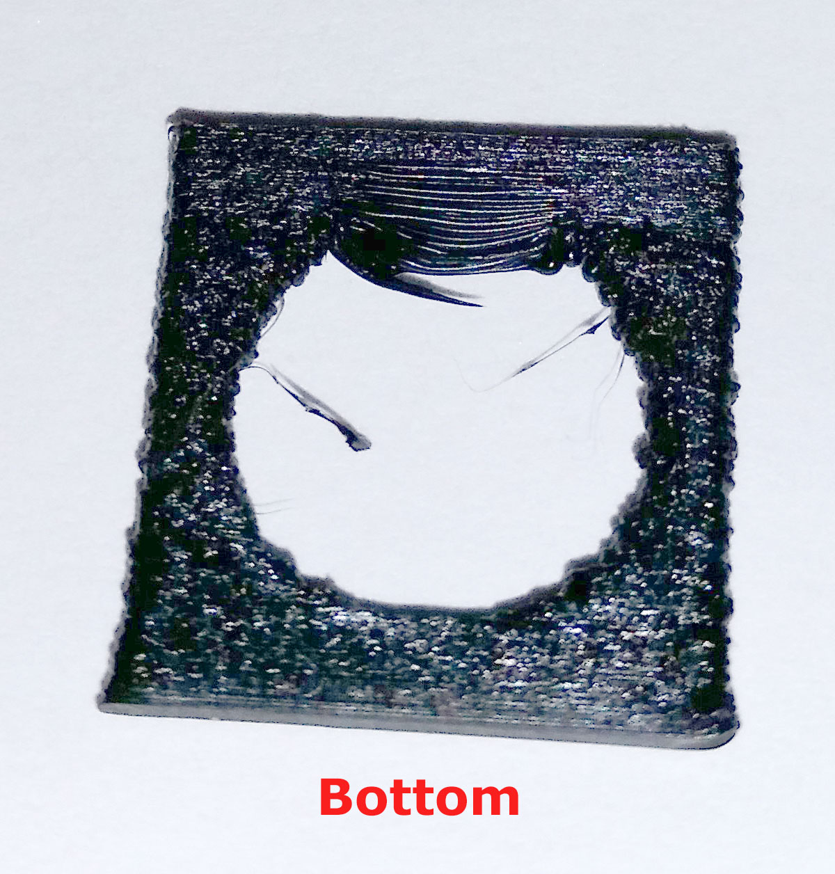

I’m trying to diagnose an issue I’m having with a Robo3D printer. Printing 60mm/s to Black Hatchbox ABS. Bed temperature = 80C,. Hotend temp I’ve tried between 224 and 228C. Retraction is .6mm at 60mm/s. I created a test at .5mm thick, 15mm tall and wide. For one its not printing smooth, and for two and most importantly the overhangs always sag, badly. Even when printing top layers (5-6) it ends up potted.

With ABS its been doing it pretty much the entire time I’ve had it. I thought too hot as well, but I’m at the lower end of the temp. settings for ABS. Also as I went lower it got worse. I did a comparison I did at 230C vs 224C and the 230C was a better result but still not perfect. Also the 230C one has less retraction.

By the look of the plastic, it was overheated. Your particular machine’s temperature sensing may give slightly incorrect values, and different ABS formulations will need different temperatures. Set your temp only 5 or 10°C above what is needed to extrude and make it stick. The actual numbers aren’t that critical until you know how your machine behaves with that filament. For example, I print ABS at 205-215°. That’s a big difference from some of the numbers being reported here.
Also, like the other said, that part is too small for adequate layer cooling.
.5mm layers are pretty large, layer height less than 80% nozzle size should give better results.
Thanks for the suggestions. The layer size is .1, the extrusion with is .4 (nozzle size) and the wall is .5 just so it wouldn’t get confused. I wanted something I can print quickly. Not so worries about the buggers, those are from the size. My concern is the sag where there is an overhang. That’s the problem I’m trying to diagnose. It does that irrelevant of the size of the print. Obviously as the overhang gets bigger so does the sag. But as I mentioned even with a solid object the top layer gets pitted relative go the percentage infill. I get good adhesion because I use glue stick (best thing since sliced bread) and it grips good.

Yes that was an earlier problem I had but was long since corrected. I just found an article about bridges and it said slow down and reduce extrusion amount so I’ll try that next also. Thanks all.
