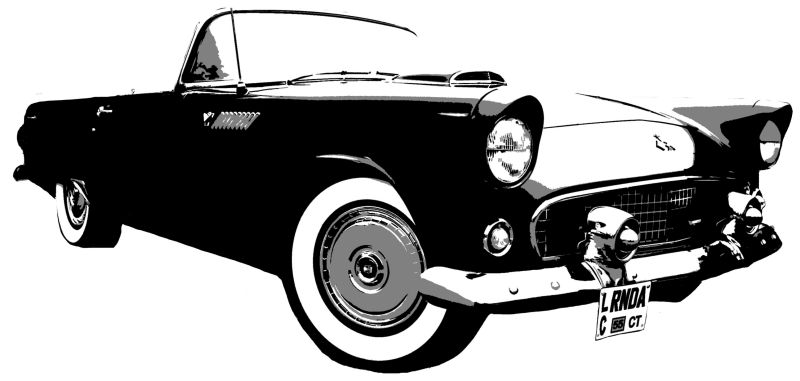

My issue is getting it into corel laser as a decent vector format. No idea. If you look at the front bumperette for example, in my picture, it is too complex for the laser. It would never work. I could probably use photoshop and simplify it but Id really love to find a plug in or process to really posterize it, vectorize it and import it into corel laser to cut.

This is what I have so far. Check out the front. Too complex for a laser.

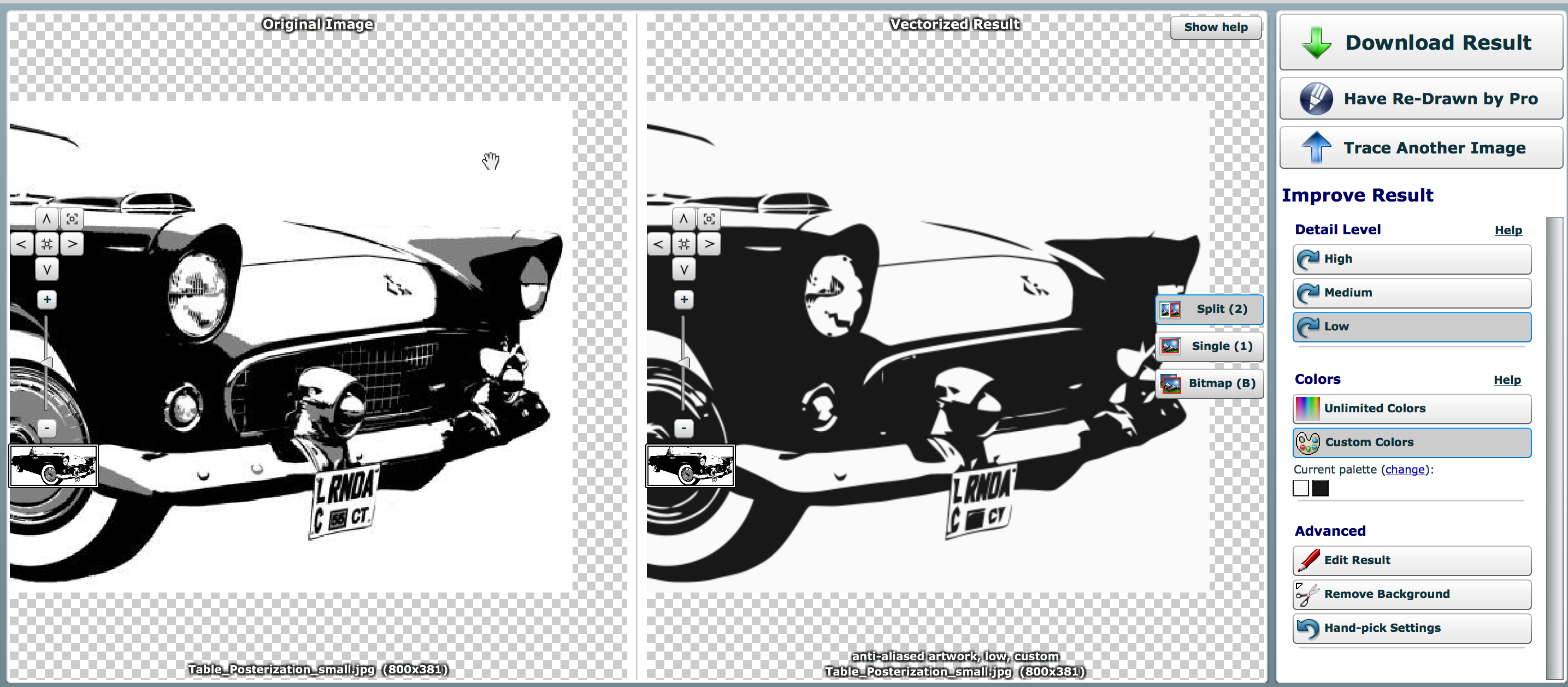

Through an online search I found http://vectormagic.com. It seemed to do what you might need.

Thank you both. @Vince_Lee I had no such luck in my searches but that looks great! Ill try both methods and see how it goes!
